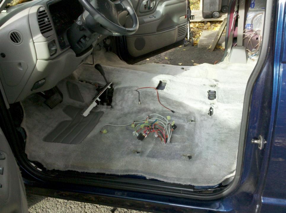

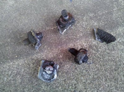

Finally got the bolts removed...via 3lb mallot and chisel! I couldn't grip the fork at dinner Sat night...but I digress.
What a job, but 75% of the interior is back in and I am cleaning like banshee. The sooner this project is done the sooner I can get to the Headers, Exhaust, plugs/wires and 2nd battery before the winter weather really sets in.
Here are some pics....
