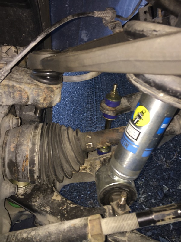

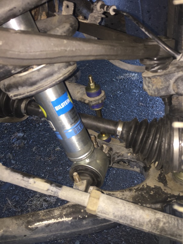

Driver side
Pass side
Looks good and still have to do the rear today as well. What y'all think about those angles haha I'm even debating about knocking down or cuttin out the bump stops some but idk. It drove ok and I think the pass side cv shaft is going bad it was popping some and when I had everything apart yesterday it was pretty stiff and not the new type stiff it was hard to move at all even when I was trying to manipulate it the spindle in place.

Angles aren't bad. I would drive it at those angles. I think your ok on the lift just the uppers can be replaced to correct ball joint angle. Add a coil spacer to the rear for leveling.

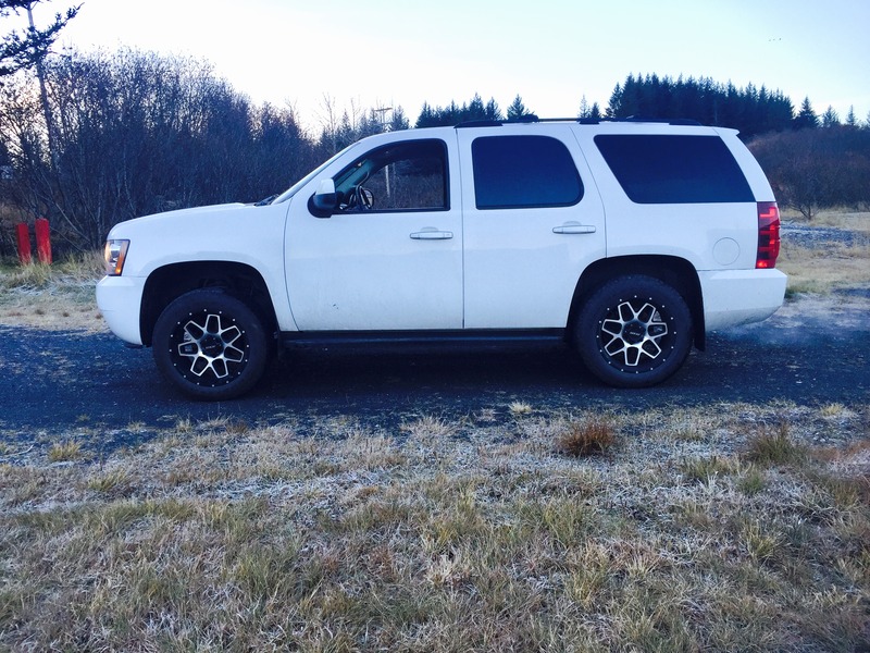

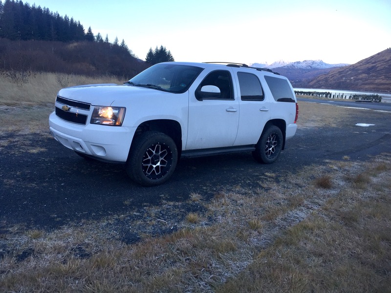

I went ahead and went down on one notch on the shocks. Now I have about a half inch between the UCA and the bump stop. Much more comfortable with running that till I can get full suspension kit.
Final product but still was unable to get the rear done. Pretty sure that's a good 30 min job and I had to leave the shop for the day. Next time.
