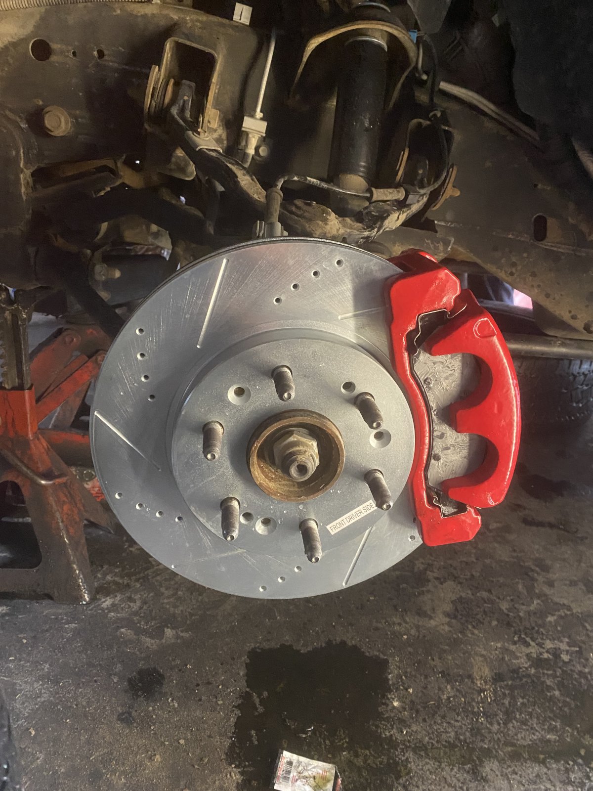

If you’re referring to the 1500 trucks, then yes.
However, most NBS (00-06) 1500 trucks came with dual piston rears, which are arguably better than the subsequent calipers, so a refresh on the rears is all you need anyway.
Keep in mind you’ll need 20”+ rims in order to fit over the big calipers (along with ideally the 1.34” bore brake MC from an NBS Escalade and hydroboost to make them really chirp).
Btw I didn’t go with the 2019+ upgrade on my NBS 1500 because of how pricy the parts were at the time…
Instead I installed the NNBS (07-14) calipers/rotors… Super easy swap, much cheaper and it’s the best braking setup I’ve ever had on any truck ever.
