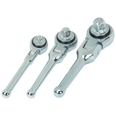

@gmartin1215 You need to pass a bolt through the the upper coil cup? My go to when working is tight places like that is to use once of these flex head stubby ratchets from HF. Basically if you can fit your hand or fist up there you can get one of these in there also.
