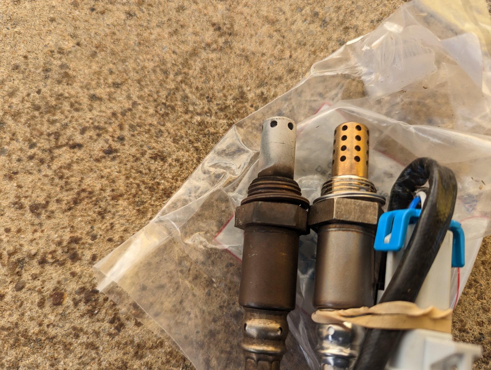

Just an update, when I changed my upstream sensors, I seen the old ones were white. I did get a lot of bank lean codes lately. I believe they were OEM. The denso have more holes. I'll try to post some comparison pics.
