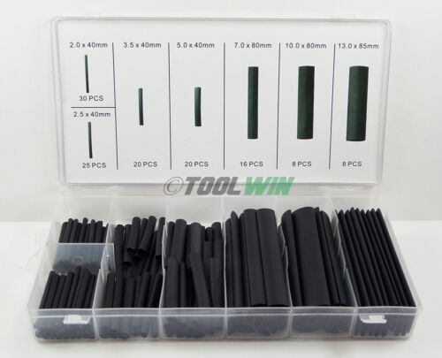

Alright so I carefully and methodically attached the new connector with new wiring as well. I did this just in case I am wrong about my deductions noted above and there is in fact a break in the wiring I didn't see. Remember when you do this, the wiring colors are different on the connector and some colors on the old connector are exactly the same!:oops: So I would handle each wire one at a time. I used this connector which comes with about 18" of additional wiring...
I used the red ones out of these type of connectors ( but keep reading )
These are also essential as the connectors above often will melt through and expose wire! Super important! I think I used 3/16" tubing. Just cut to size ( a little larger than the solder connector ) and run this up the line first followed by the shrink solder connector and take your time. Shrink the solder connector first. Keep the heat on the center of solder connector until you see the metal in the center get "liquidy" then work the gun to either side until you see a good shrink seal. Wait bit for it to cool off, then slide the tubing over it and shrink that into place as well. As noted above, DONT FORGET TO SLIDE TUBING ON THE LINE FIRST FOLLOWED BY THE SOLDER CONNECTOR before you apply the heat to the solder connector.
Finally I used something similar to this to shrink the connectors...
This method would also apply to the connector at the throttle body. Hope this will help someone. Thanks for all your help. You know who you are!:D
