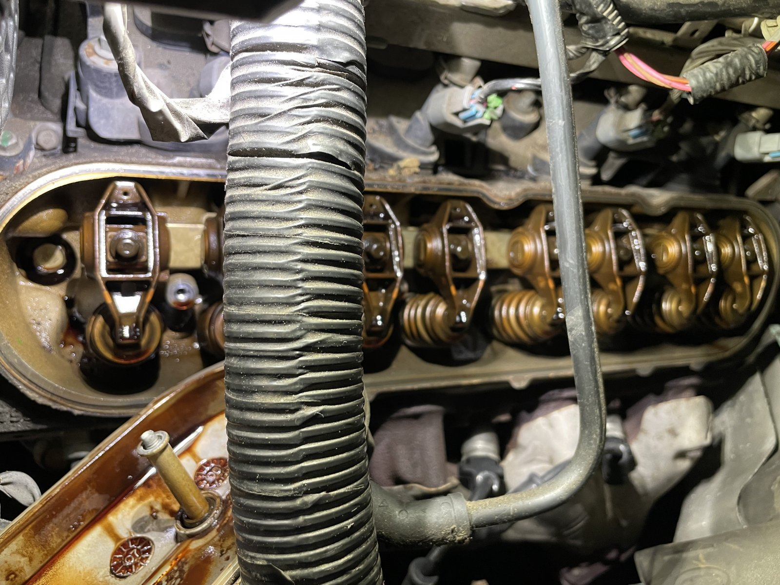

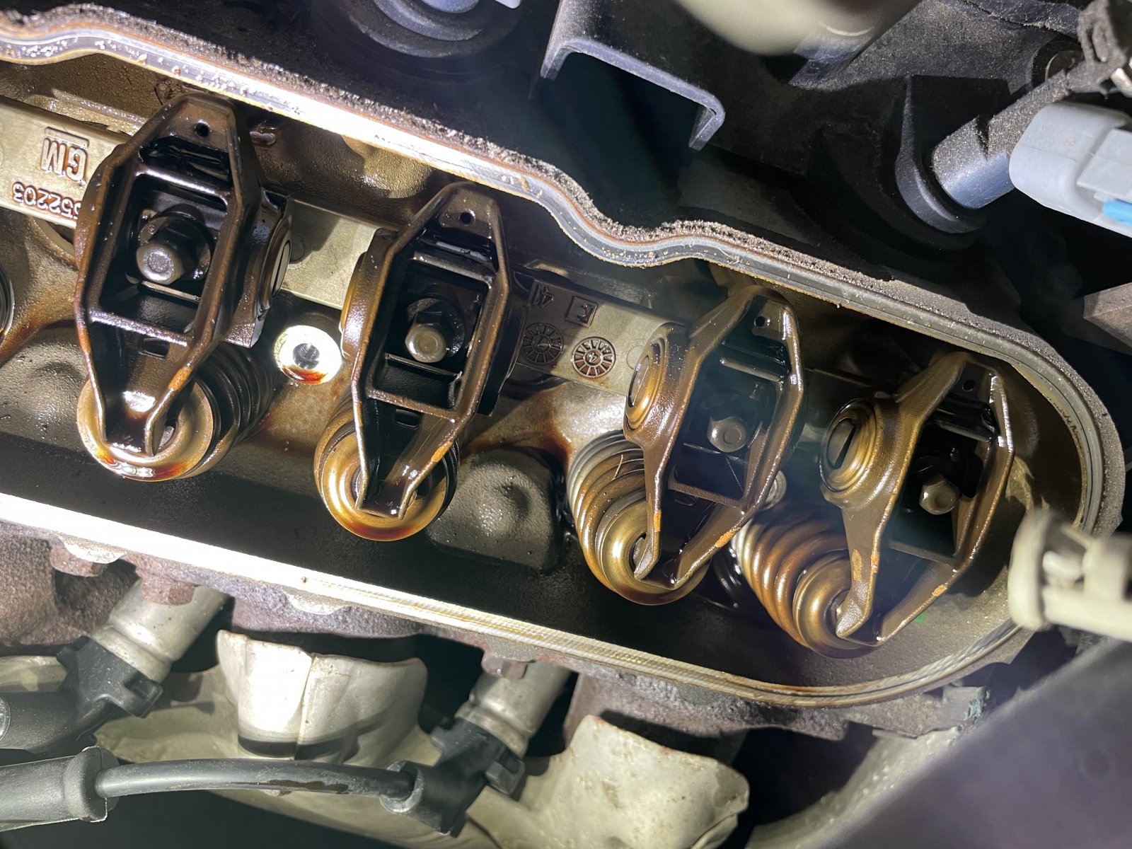

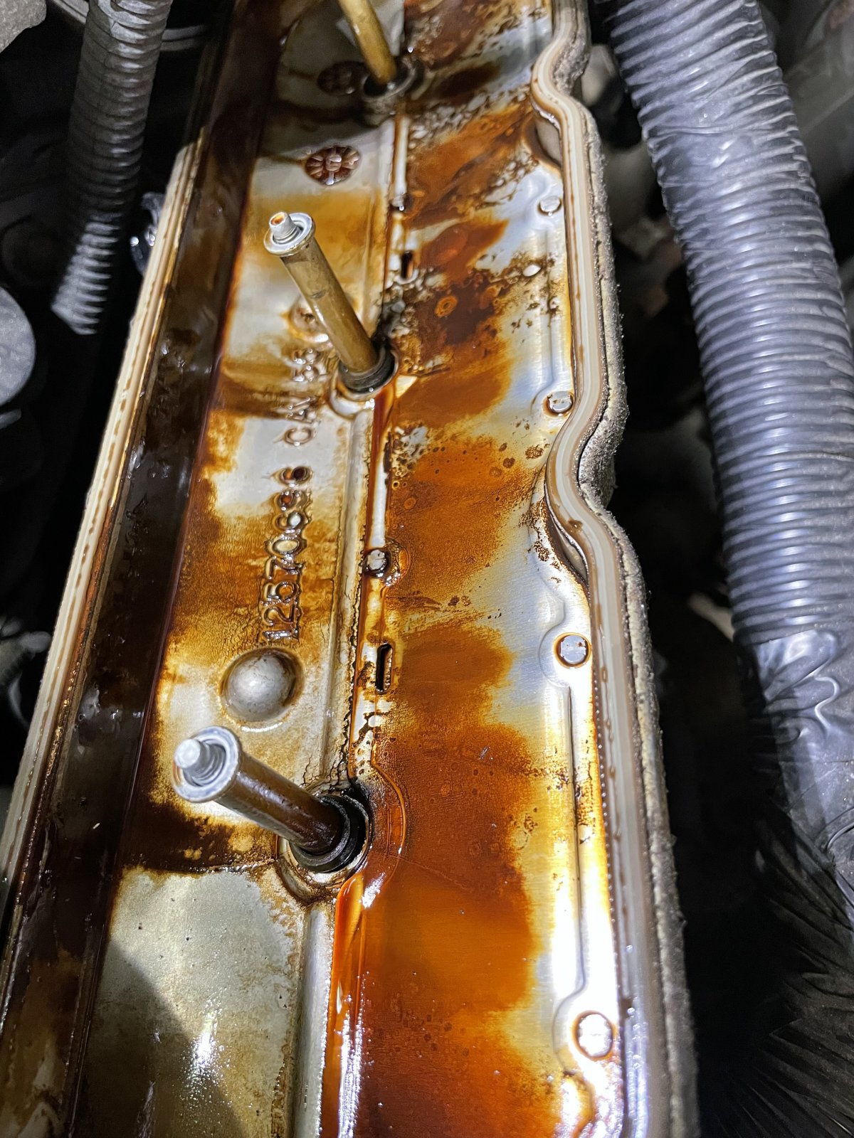

The new PCM is in and I did the Crank relearn, no problem. No other errors.
I also took off the valve cover. It looks good especially for 190+K miles
21,276
30,207
Looks good and that is the old valve cover, not the new and improved one which is 12570427 for 2007-2008.
Keep the oil clean. Take a picture of the underside of the intake where the VLOM is, maybe we can tell if you have the new one or the old one.

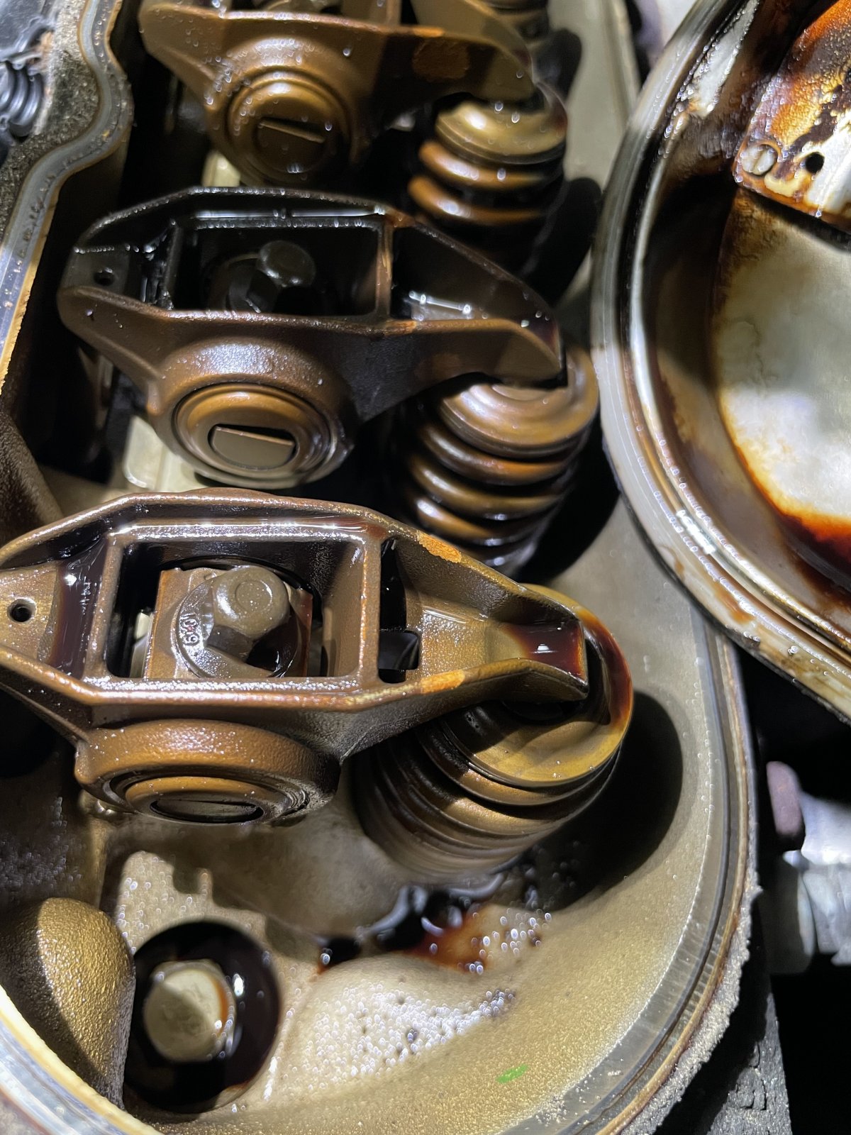

Two questions, as shown on one of the pictures one of my rockers looks black. Anything to worry about? The other thing I've been told these LS type engines have needle bearings in the rockers that are prone to failure and that it's common to convert to a bushing instead. Is that something relevant to the 5.3 or just the real LS engines like the LS1 etc.?
Thanks!
View attachment 381161View attachment 381162View attachment 381163View attachment 381164
Awesome! Yeah, it looks pretty good in there, especially for the mileage.
Thanks!
I'm wondering if that rocker is in line with the hole in the PCV baffle and it's just from years of oil dripping back onto it and cooling when parked. It's great that you don't have any or much oil consumption, but I'd still get that updated cover.
I wouldn't say the stock rocker bearings are "prone to failure". At least, not in a stock setup. They're the same rocker design used across all LS engines including the high-performance car variants spinning 7,000 RPM and with more cam action happening. To me, the reports of their failure has become more of a Hegelian dialectic. I'd trust the stock ones over the bushing style. I researched stock and aftermarket needle bearings versus the various bushing styles to exhaustion a few months ago. My TSP cam is decently comparable to a stock LS6 cam and I have the "heavier duty" LS6 valve springs and my redline is about 600 RPM less than that of the LS6. I decided that if stock rockers do fine in an LS6, they'd be fine in my warmed over LMG. Problems arise with stock bearings (and still with the aftermarket bushings) on more heavily modded engines with big cams, high spring pressures, higher RPM, etc. I did my engine refresh at 200K and put the original rockers back in with the intent to swap them later once I had settled on some aftermarket ones. They did just fine with all the "abuse" following the refresh with upgrades, but I wanted the peace of mind of at least having something new. Back in May, I bought 16 new GM OEM rockers off eBay for $9.99 each and haven't given it a second thought. If I were to go aftermarket, these are what I'd get: http://www.ws6project.com/user_stor...cts_id=9356&osCsid=med8ej8uujfipsmotus6cus9s1
I did see that and thought to myself that if it had gotten hot, it would be kinda blue. A lot of these motors had AFM failures by around 100K and if caught early were easily repaired with the latest parts with no damage to the engines.
