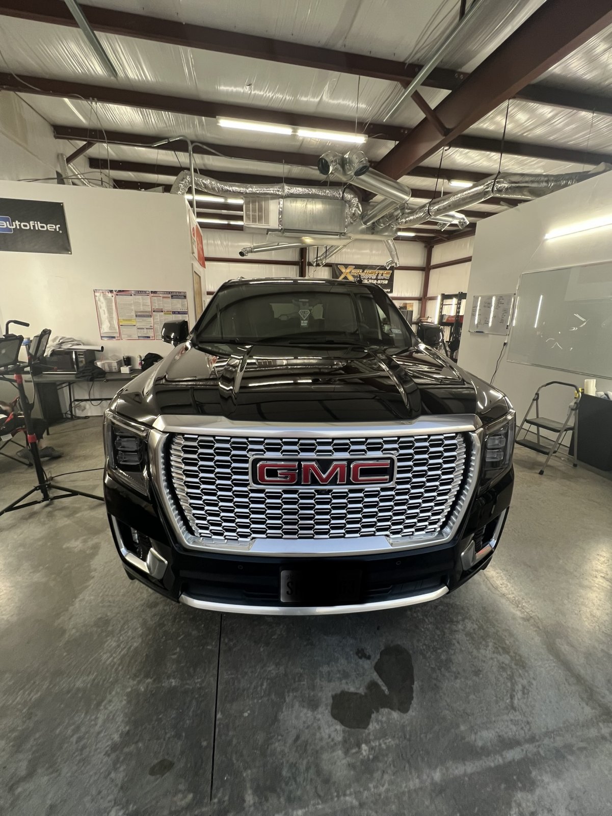

I’m going to put PPF in the hood/bumper/headlights and then ceramic the whole thing.
Yes I don’t have time to do the whole prep thing so I rather have a professional do it.
