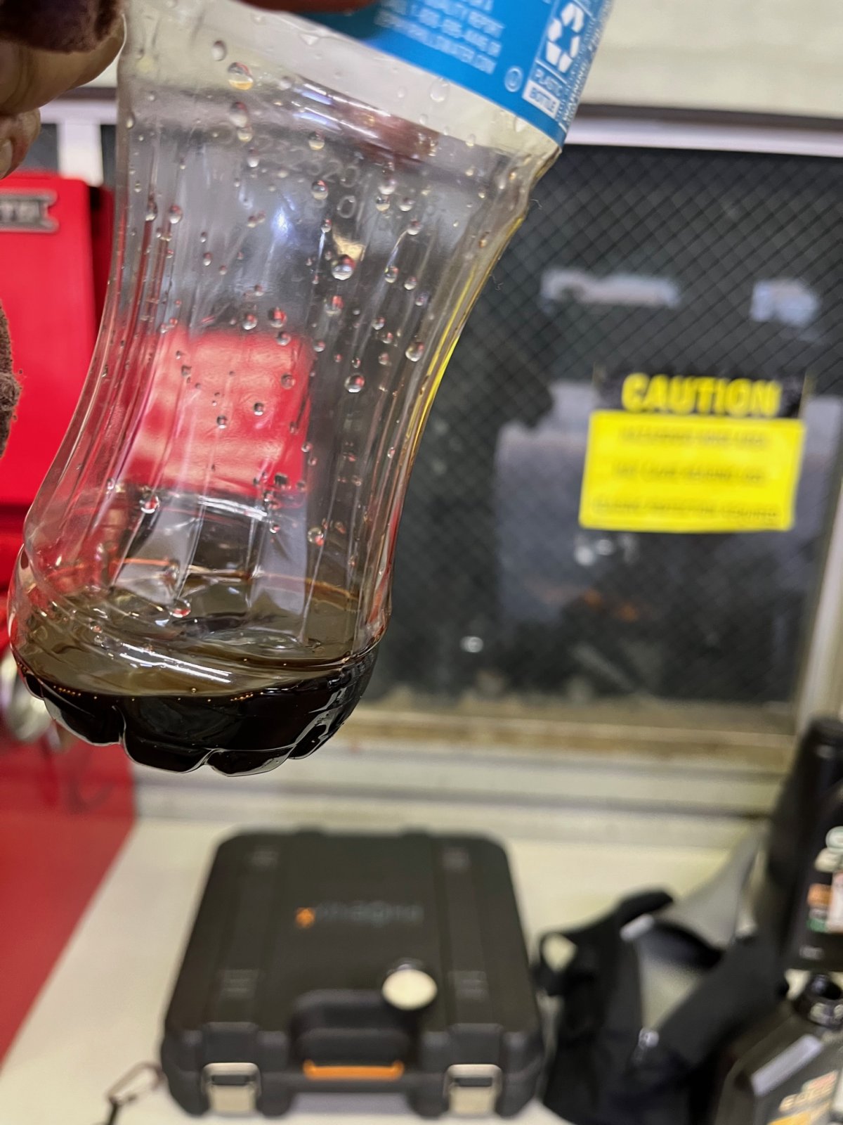

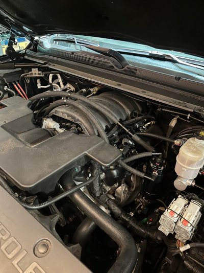

Got your post. Checking at 50% oil life. UPR dual setup w/ CCS after 45K. Dumped every 5k oil change
