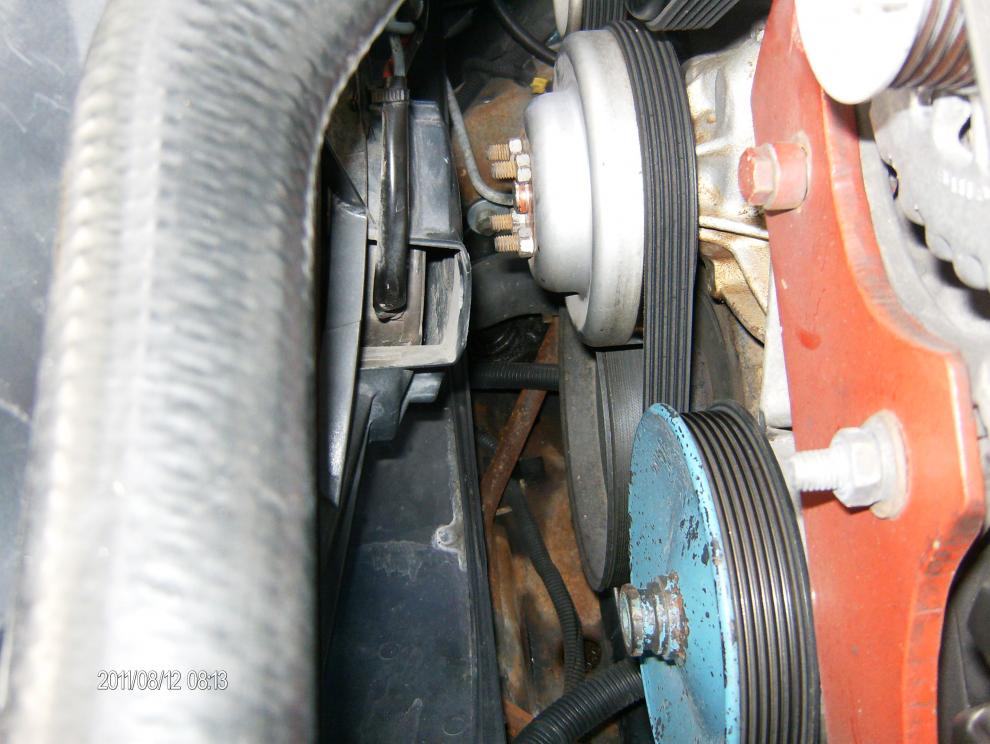

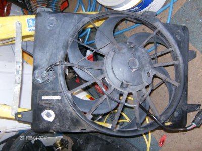

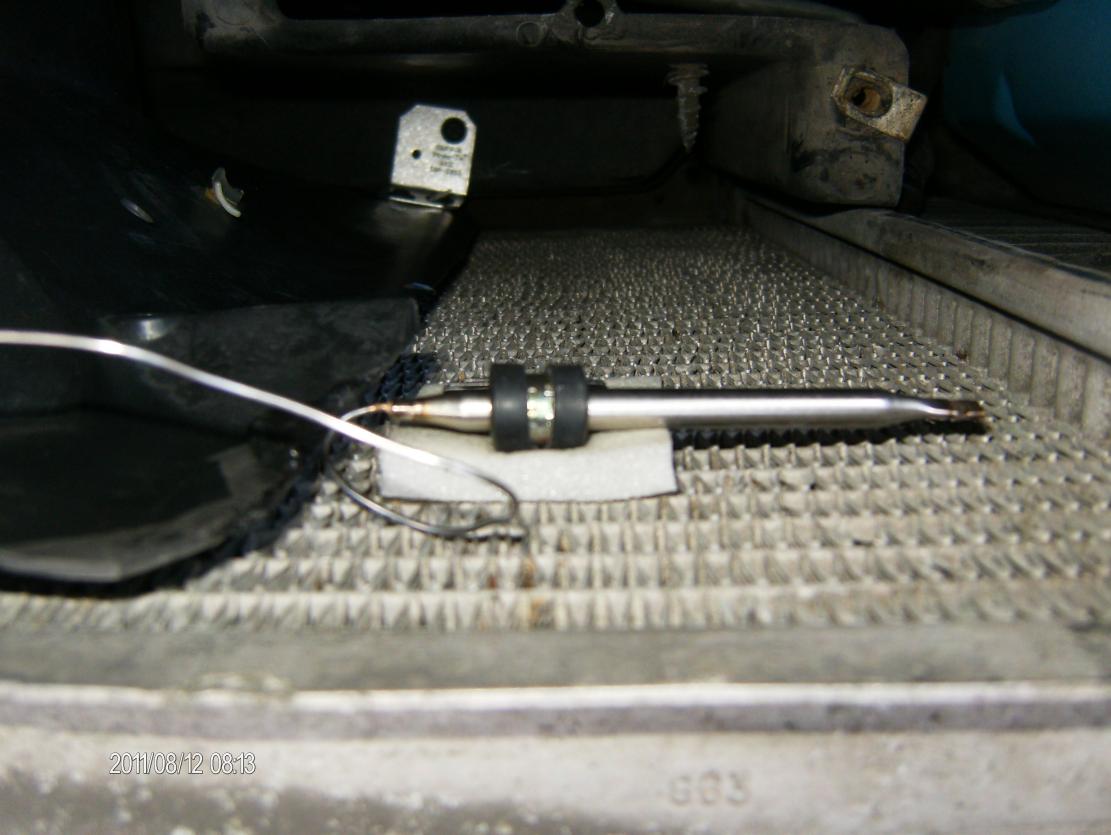

qukon 95
Apr 7, 2011
556
here's some pics L 2 R fan off a 2000 town car,2 spd relay,fan control probe, shows the
space between the 2. i do want to take the pulley studs out and put bolts in it.
