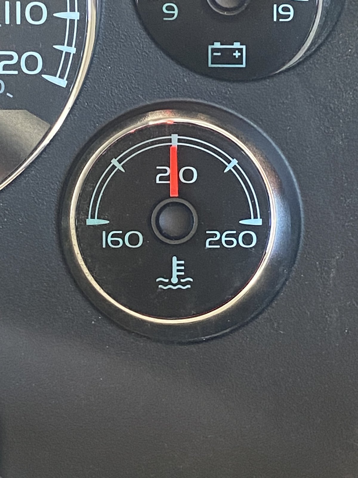

Anyone coolant gauge ever do this? Am I being picky?

Am I being too picky? I’ve seen this in other vehicles and they were fine. Does it mean anything ? I feel like usually it is spot on.

Viewing the engine coolant temperature with a scan tool, the factory analog gauge is inaccurate and typically hovers near 210 degrees even if temperature is only 195 or so, and I'm not sure where on the high end. Take that in to consideration.

My ride runs cooler than 210 especially cruising at 70. View attachment 410071
Something doesn't seem right there, or you have an aftermarket thermostat with a much lower temperature installed. Or if you haven't done any work at all - have you removed the thermostat housing from the water pump to inspect it? I would be interested to see a scan tool's reading of this temperature. By the ((inaccurate)) gauge alone it looks to be pointing to around ~185. I bet it's lower than that.

I have no idea, been running like that since I got it. Never checked it myself. I did change the TVB to the lower temp one.
I would double check. Also would be interesting to know if your truck is ever reaching closed loop mode depending on how low your operating temperature actually is.
The transmission cooler bypass thermostat should not have any effect at all on your engine coolant temperature.

It doesnt. It only affects the temperature of my transmission fluid, which is also runnning lower than most as well. In city stop and go driving both the radiator and transmission fluid see an increase in temps.
