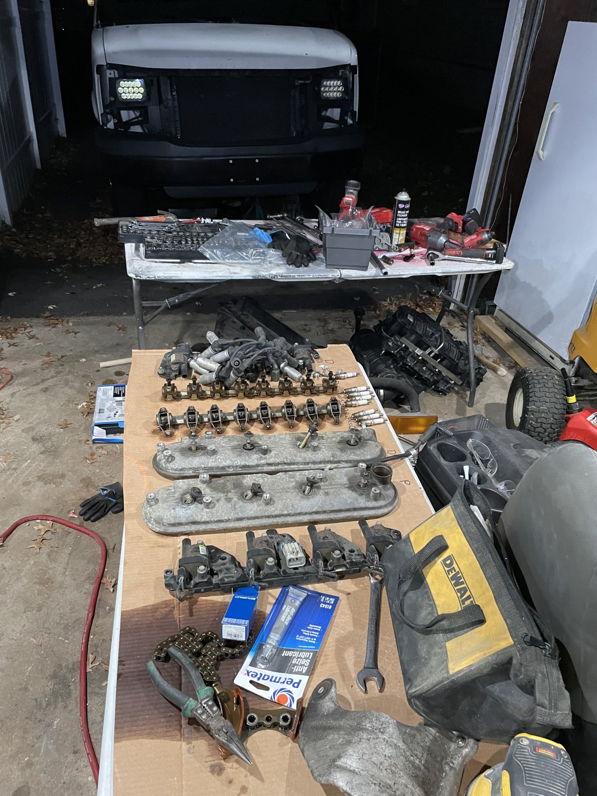

so I hope I’m not overreacting. But I did a make shift leak test. Cranked cylinder 7 to TDC and hooked up compressed air. It’s hissing through the oil fill hole. Quiet though the TB, exhaust, and antifreeze tank.. However cylinder 8 is doing the same. Didn’t get a chance to check the rest. Free time is at an all time low lately

When you say you only notice the miss at idle, that leads me to believe a vacuum leak. Before I go further, I want to know the test results of the other 6 cylinders.
With just the two cylinders having air at oil fill: Piston rings bleed by, cracked head/gasket....etc. ?????
A compression test with dry and wet results would help pinpoint.

Found this tiny vacuum leak with a smoke tester. Could this be big enough to cause rough idle/misfire?
Right above cyl 7
