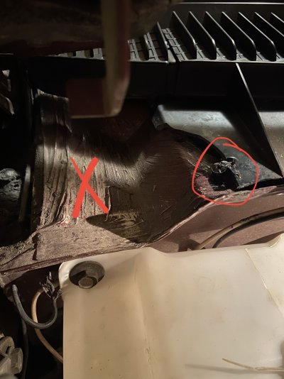

Here is where I’ve always seen leaks, but it’s on three 98 models. It’s likely the same as a 94, so maybe it will help.
Pulling the carpet back and watching from inside while someone runs a hose is helpful.
1. Radio antenna grommet loose, though that’s usually the result of the dash being pulled. It’s under the blower.
2. Cowl plastic screw needs to be sealed (circled) or the seam sealer (X) is cracked.
The screw goes into the blower intake. Pull the blower and use a mirror to look up to the cowl. Put water on the cowl and see if water is coming in. That, however, fills the blower housing with water and usually kills the blower eventually.
The seam sealer cracking is pretty common. I’ve just sealed cracks with whatever goop I had handy, RTV or sometimes weatherstripping adhesive.
Last, is water accumulating in the sill plate at the door? Pull the plate to check.
A weatherstripping leak at the door can channel water down into the sill where it can overflow into the floor and/or the carpet edge can soak it up. On my 98 Tahoe (two door) the water was coming in from the vent in the inner door panel and some of the door panel clip holes, leaking down into the sill.

Justin/East302, many thanks for the support - just to recap, I've replaced the W/S, pulled the blower motor, pulled the kick panel and sill plate, pulled carpet back and had someone hose the area above the pass. corner of the cowl area. No water around the antenna or door weather stripping but water seems to find it's way to the seam coming down from the upper intersect of the firewall and the inner fender. East302, you may have given me a clue about the seam sealer - it looks like it is sealed but the way it is "brushed" on the surface there could be cracks that don't show up to the naked eye. I think I'll spray that area with 'Flex Seal' sealant and add some silicone around the cowl screws. Appreciate the pics, those helped to see your seam sealer looks the same as mine. I'll let you know if this works.
