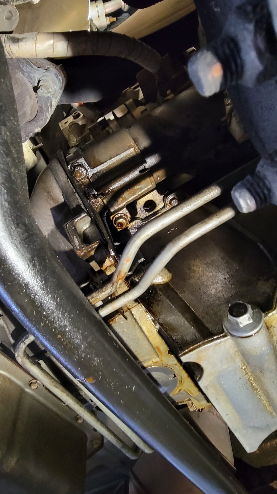

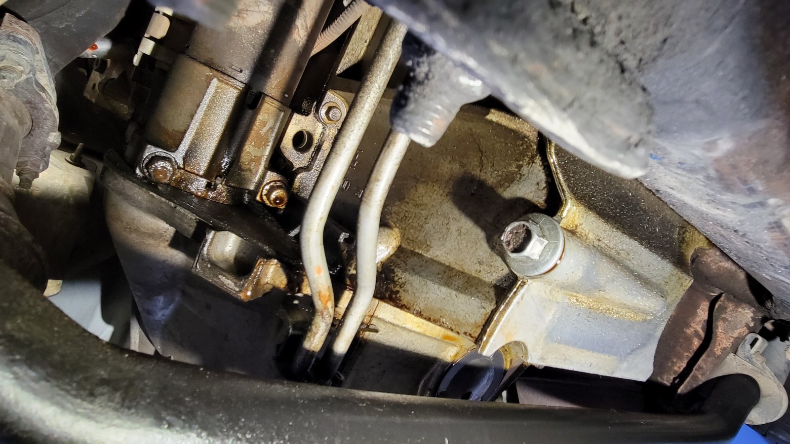

Hey everyone, I'm hoping to get some help with diagnosing the coolant leak on my 2011 Denali. I noticed the coolant level was pretty low in the tank and filled it up. I went out for some lunch after and when I came back out to the truck, it looked like someone basically poured out a new bottle of coolant under the engine. It has been parked for over a week and it is still slowly leaking. It is coming from above the oil drain plug (photos below). I am hoping this is something I can fix myself as I don't really have the extra funds available after Christmas to take this in to get done. Any help is greatly appreciated. Thanks!coolant leak1.jpgcoolant leak2.jpg

Most likely the source is the passenger side heater hose/t's on the firewall
but.. could be other things, waterpump, hose, reservoir tank crack, radiator.coolant leak3-1.jpg
