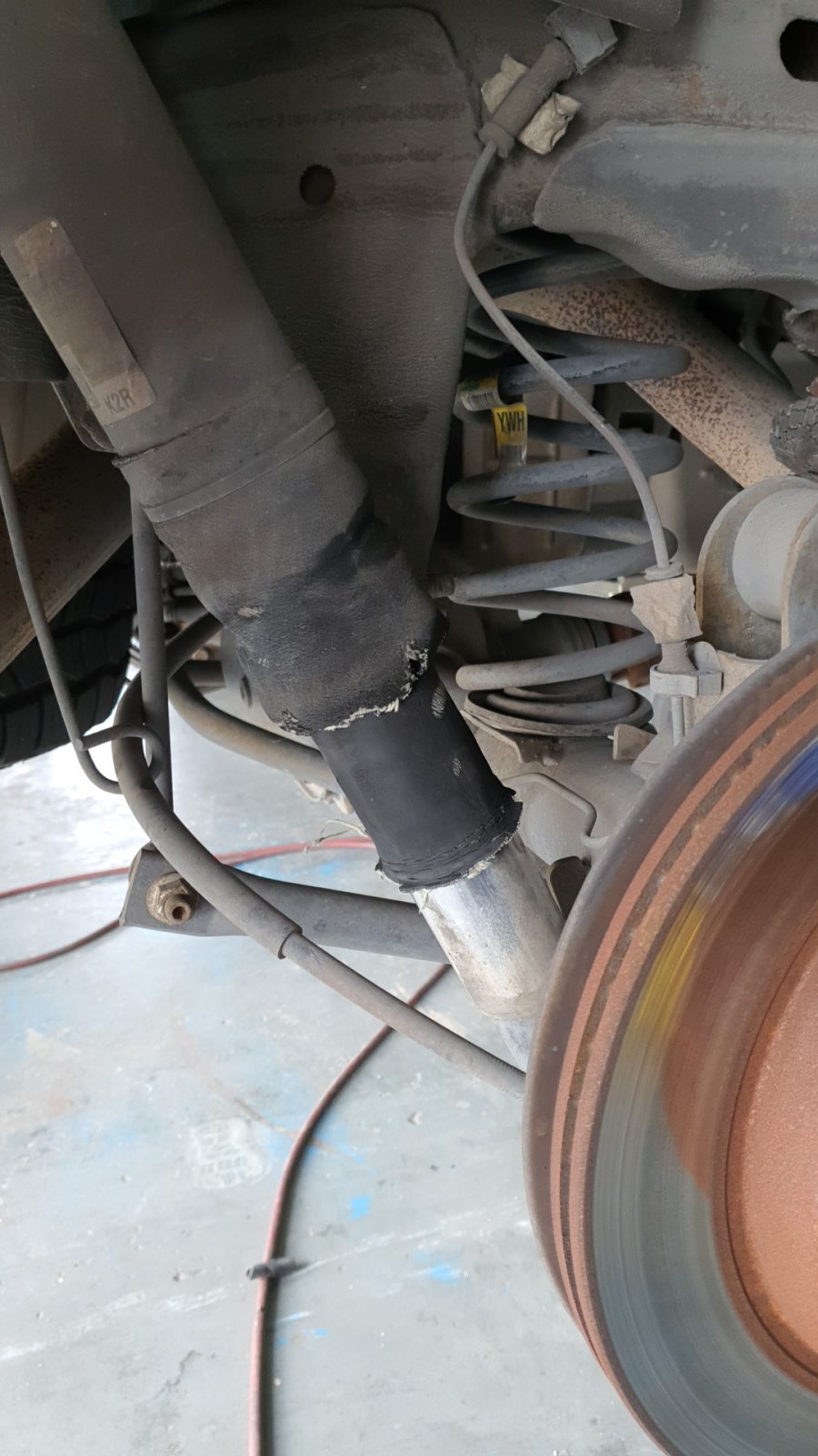

About to drop in a set of pads on rear brakes, noticed that the boots on the air shocks (Z55) have both torn. Looked at multiple diagrams, thought I had a part number but turned out was for front boot on the struts.
Anybody have a part number for this boot / dust cover? Or maybe perhaps a pn for an 'accordion' type of shock cover that fits? Both still work / hold air / compressor only runs when supposed to.

Compressor runs when turn key for a few seconds. It will run for longer if situation calls. Ran for 20sec or so last night when filled up. Went from 25miles left to 490miles left.
My Yukon sits level, makes adjustments when add in bunch of weight in back (pressure washer, 5gal fuel can, table saw, sockets, groceries, personal gear) when I go and work on beach house. Can't say I have heard it relieve pressure though.
This is what I am looking at. Pics taken when had brakes inspected (upgrading to LEO or Brembo) and mechanic pointed out 'boots' being torn.
No dash lights or warnings other than parking sensors.

Wow. Those are the bags and they’re blown. I say there’s no way those are holding air. You can do a test by starting the truck and after the compressor runs and shuts off, remove one of those air lines and listen for a lot of air coming out. You’ll want the weight of the truck on the tires so use a set of ramps to drive the rear up on if you can’t lay under it and reach it. You can also remove a wheel and put a jack under the axle on one side so the weight of the truck is on the jack. Removing one line will let the air out of both shocks. Those bags should be hard when they’re full of air.

Well...@#$%.
At least I was able to find those shocks on Amazon.
Any other PM I should pay attention to while changing shocks? Bumpers (frame) look heavily worn out / cracked. Will do those too.
