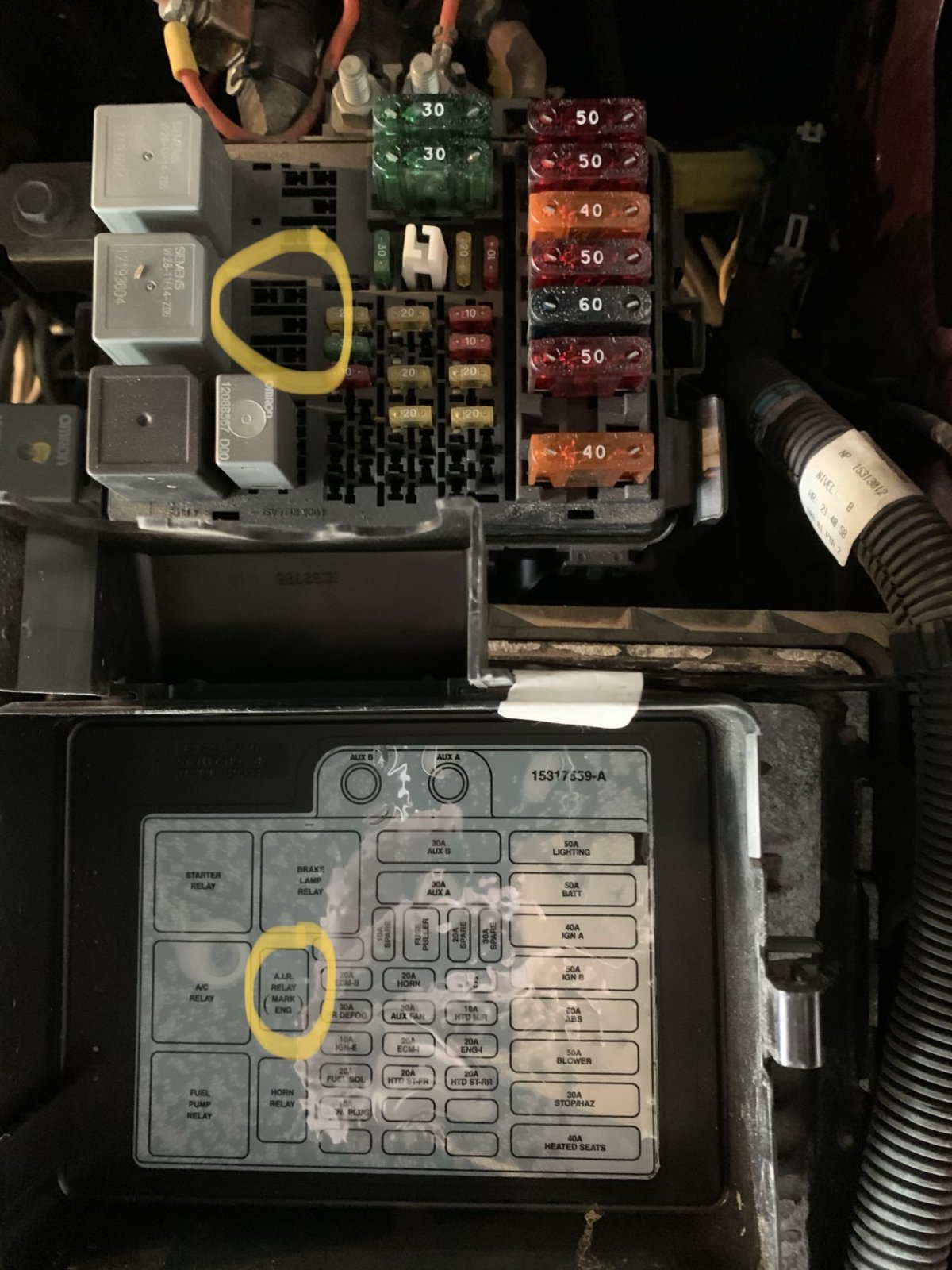

You don't. The electric system is controlled by a relay that is triggered by the drivetrain computer(PCM). Your relay may be shorted out or your pcm might be faulty or is commanding it on all the time for a reason. At any rate the power feed to the pump thru relay control should be the AUX B **** fuse under the hood if you want to disable it until the primary problem is solved. Relay is in the same electrical box. Are you not showing any other problems or warning lights? Can you test your relay?
