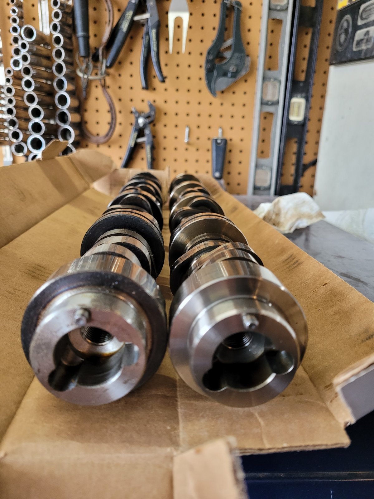

@MrMonte Do some research on GM 12664572 you should be able to find one for <$200.
I believe that is a GM OEM Non-AFM cam you can swap into your L86 and retain stock drivability, drivetrain characteristics, and fuel economy.
I ordered the GM 12664572 cam. This is the same cam in the Escalade V. This cam will go nicely with the future supercharger install.

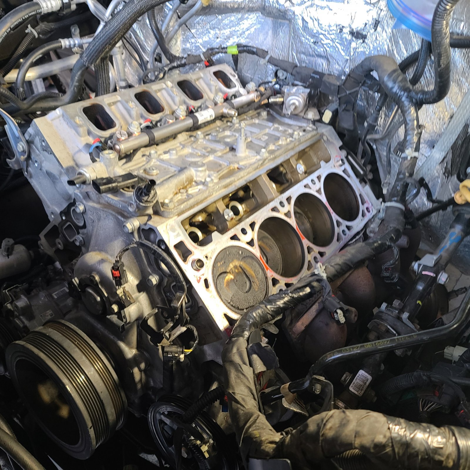

Only spent 2hrs on the Yukon today. Was determined to get that intake cover off then bagged/labeled all bolts removed so far then sprayed exhausted bolts since they tend to break. Removed all pushrods & rocker arms which all look good.
That wiring bundle attached to the back of the intake cover was a pain. I ended up removing the alternator so I could remove the intake leaving the intake cover still attached by 4 connectors in the back which I could now reach.

As for my Yukon, hoping to get my cam this week I checked the status & it was cancelled due to backorder even though when I ordered they said it was in stock. They didn't let me know it was cancelled. I ordered a Scoggin Dickey cam which spec wise looks to be better than the ZR1 cam I had order but was $100 more. I did remove the exhaust bolts from the Yukon today so some progress. I have to work 50hrs between now & Wed morning so not much happening on the Yukon for a few days.

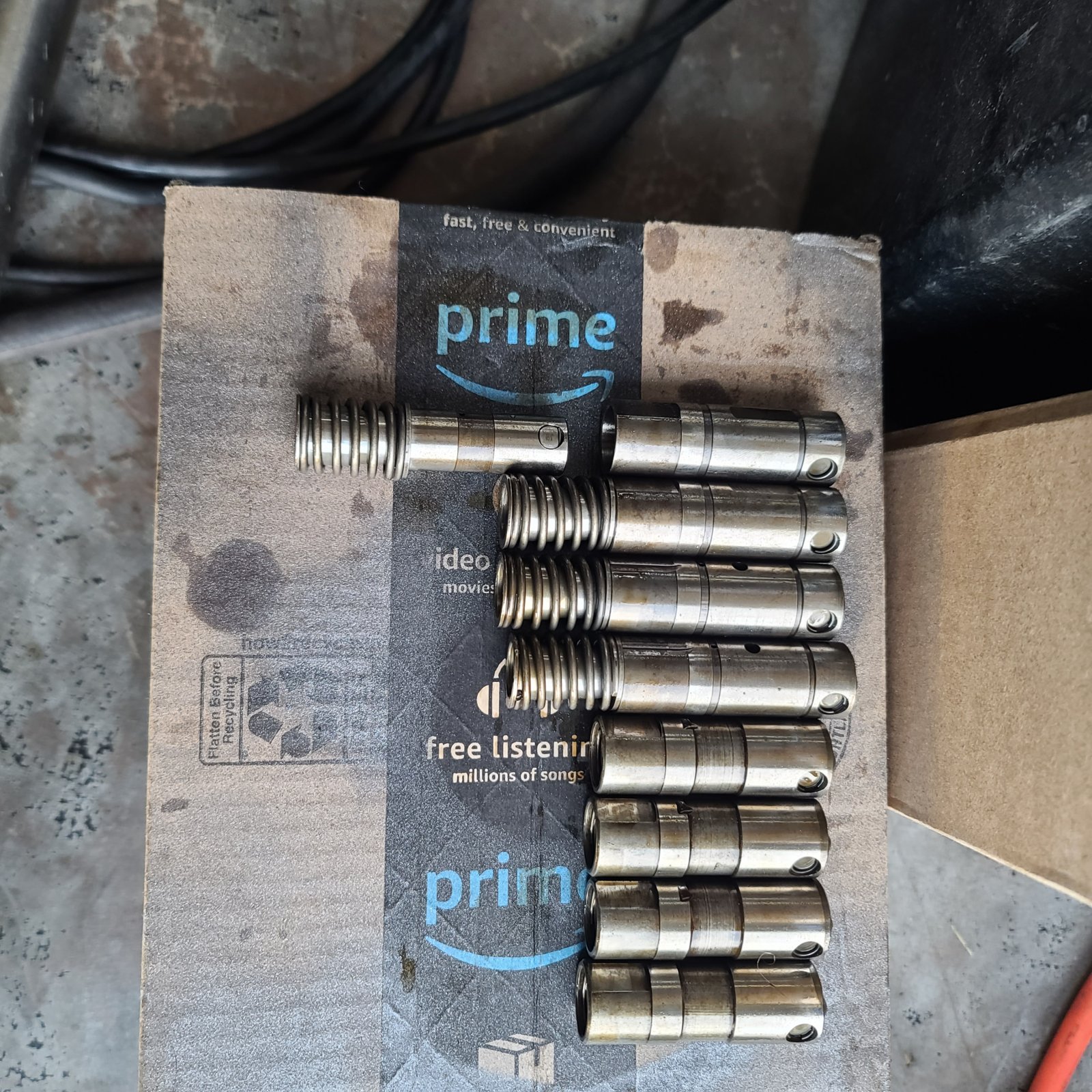

Still waiting on my cam & a harmonic balancer puller so progress has been slow. Pulled the water pump & the head that had the lifter failure. All rollers on the lifters are good as well as the cam lobes. The bad lifter separated. Harmonic balancer bolt has been removed with the help of a 5 second blast of heat & a HD impact

Less than 1 minute after the harmonic balancer puller arrived I had the harmonic balancer off.
Cleaned the carbon off the pistons. Tried for a few minutes to remove the timing chain without loosening the oil pump like the video I watched but didn't get anywhere. Haven't given up but I did order the oil pump alignment fixtures just in case. AFM delete plugs are in.
