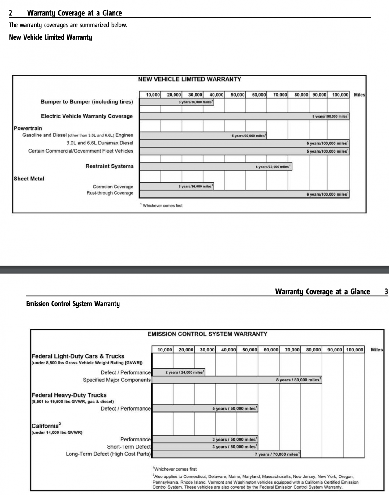

WalleyeMikeIII
Feb 22, 2022
2,767
2,637
Sunny and Snowy Minnesota
>> We all have 5 year, 60k mile power train warranty to find out. <<
My new 2022 Tahoe that I waited nearly a year to get only came with a 3 year, 36K mile power train warranty.
Pretty sure all GM Passenger Vehicles have a 3/36 Bumper to Bumper, a 5/60 Powertrain, a 6/72 on Airbags and Seatbelts, 6/100k for rust through, and and 8/80 or 7/70 On Emissions (depending on where you are).
See Chevrolet.com and search under warranty under the support section (linked for your covenience)....or check the warranty pamphlet in your owners manual package in the glove box.
Excerpt below:
