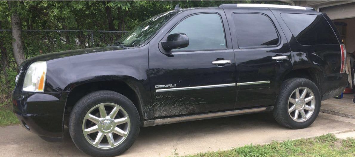

Hello all! I just purchased a 13 Yukon Denali with 120k on the clock. I am trying to do a AFM delete since I just found out about the system being prone to failing. I apologize if some of these question have been answered already, I’m super new to GM products, so coming from the JDM Honda scene doesn’t really help lol. Anyways, I want to do a AFM delete kit BUT I want to keep my vvt.
I have found a few kits online and I don’t mind getting one but I’m curious to know if it’s cheaper to piece together a kit instead ? I also don’t mind putting a kit together, but I’m just not knowledgeable enough yet on what Ls motor parts are interchangeable. I heard somewhere that “ls7 solid rollers, and an ls7 cam” works on these L94’s?
Also want to point out that I plan on supercharging the L94 with a LSA (correct me if wording it incorrectly) and since I’ll have the engine out, any advice on what to replace with what would be greatly appreciated. I don’t plan on going super crazy in power since it’ll be my weekend family vehicle. For reference on the lsa build that im interested in doing here is the link
Also want to mention that I will be gettin HPtuners to disable the system first to get a bit of breathing room. I know this isn’t a permanent fix and will still be deleting AFM.
As stated above any and all advice/help would be greatly appreciated. Coming from the Honda scene I’m a lot out of my comfort zone, but I’m willing to learn. Thanks again guys!!
Ps feel free to ask me questions.
