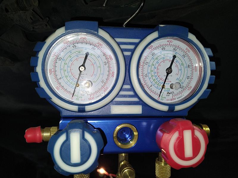

Dunno. You tell me. Got one of these gizmos, but I have no idea how to use it. Dials remain the same, no change no matter what I do, engine off, engine on, AC off, AC on, knobs open or closed.
I have a vacuum also. Does the yellow hose need to be connected to it, or to a coolant can?

Strange to get nothing, even air would have pressure from the heat in a closed system. Are the valves that attach to the vehicle, red and blue opened, if not you won't get any reading. If they are then open the red and or blue at the gauges and see if anything comes out of the yellow. If nothing comes out of the yellow hook your vacum pump to the yellow and with all of the valves open see if it will pull down into a vacum. If it does allow it to run and see how far it pulls it down, then shut the valves on the gauges and shut the vacum pump off and observe the gauges over time and see if it holds a vacum.

honestly I think your compressor is toast and or you don't have the valves on your gauge open.
youtube a quick video on the gauges.
