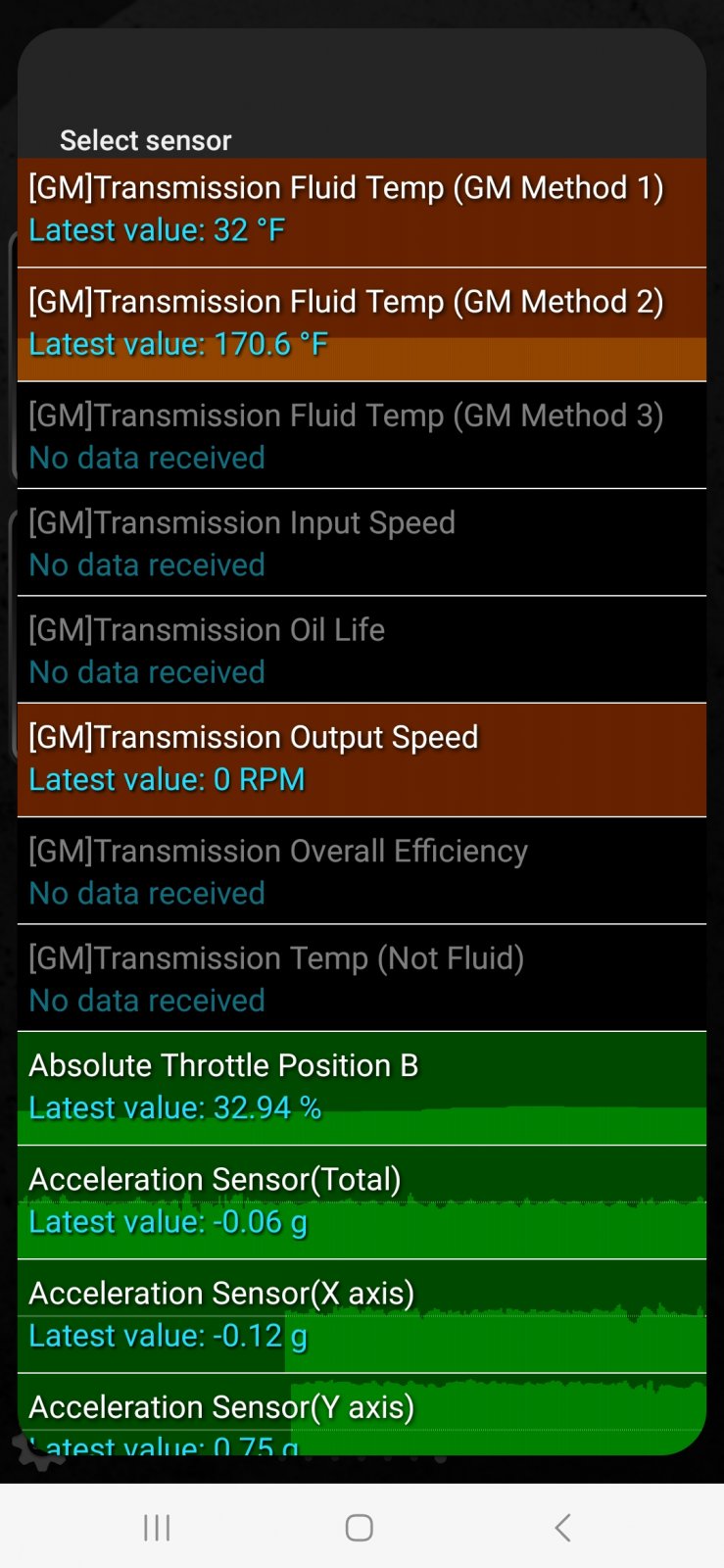

Sweet. Added. I'll go drive her around tomorrow and see what it says.
J
Jjona5
Apr 6, 2023
11
12
So the 4 speed sensors arent reading...neither is the transmission output speed.

if none of them are reading it's probably just not the correct pids for your truck. I wish I knew how to find pids, but I don't. there's. a super long thread about it on the trail blazer board. they might have some in there.
but it definitely seems off. that's why your abs is kicking in when it shouldn't. if it's worth 375$ scanner to you to fix it. one of the clone tech 2's will read all that and tons more. they are pretty invaluable if you work on your own stuff with odd problems like that.
