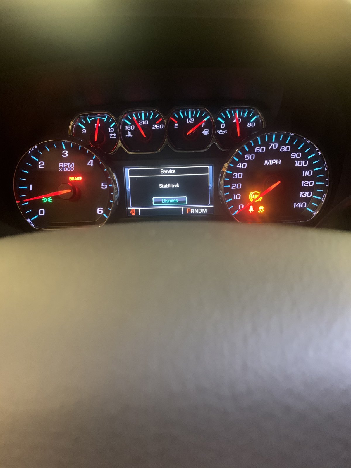

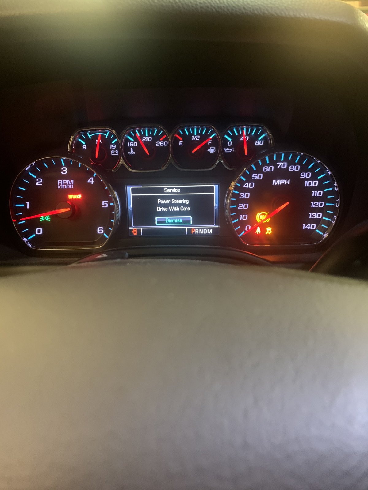

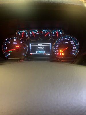

About a month ago I had this colorful dash display. I was stopped (in park) and all of a sudden my dash blows up with Service this Service that. The shop supposedly fixes it, loose negative battery cable on the battery... less then 24 hours later it was back.

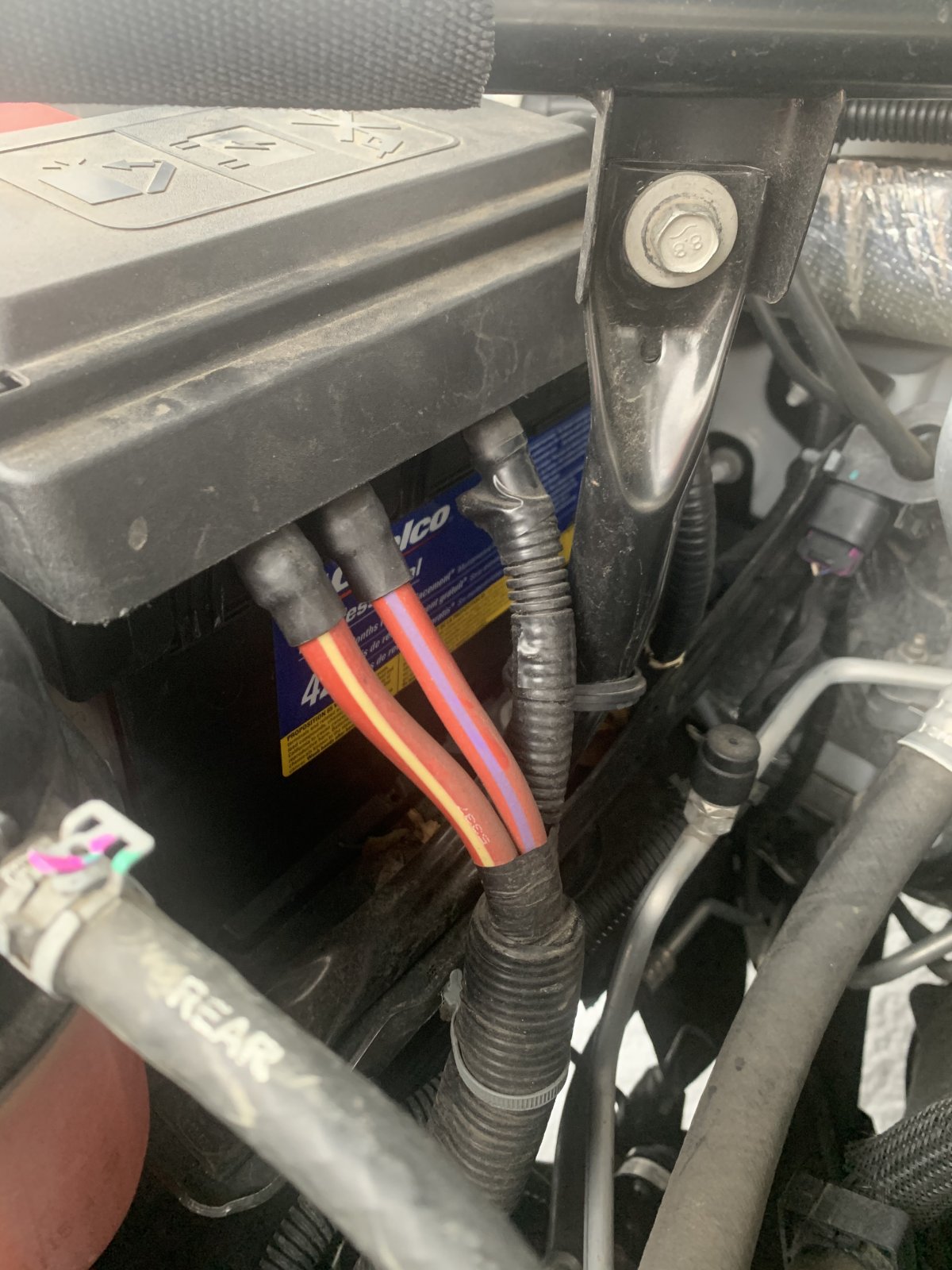

I’ve replaced the negative battery cable (the one that goes to Chassis behind RF fender liner and also to the motor). I cleared the codes that I could last night 11-25-2020... here is what the codes where last night when I went to clear them (last photo)...
Randomly I’ve had no power steering. Park it and next time I start it no power steering. Heck I’ve even had no power steering and parked it and then went to start it and all was fine for maybe 30 miles????
Lately it’s been just service stable track and trailer brake along with action required power steering reduced. Most of the time turning vehicle off then back on again “clears” it. And it might come right back on or it might be minutes/ miles or might get a trip into work (25miles).

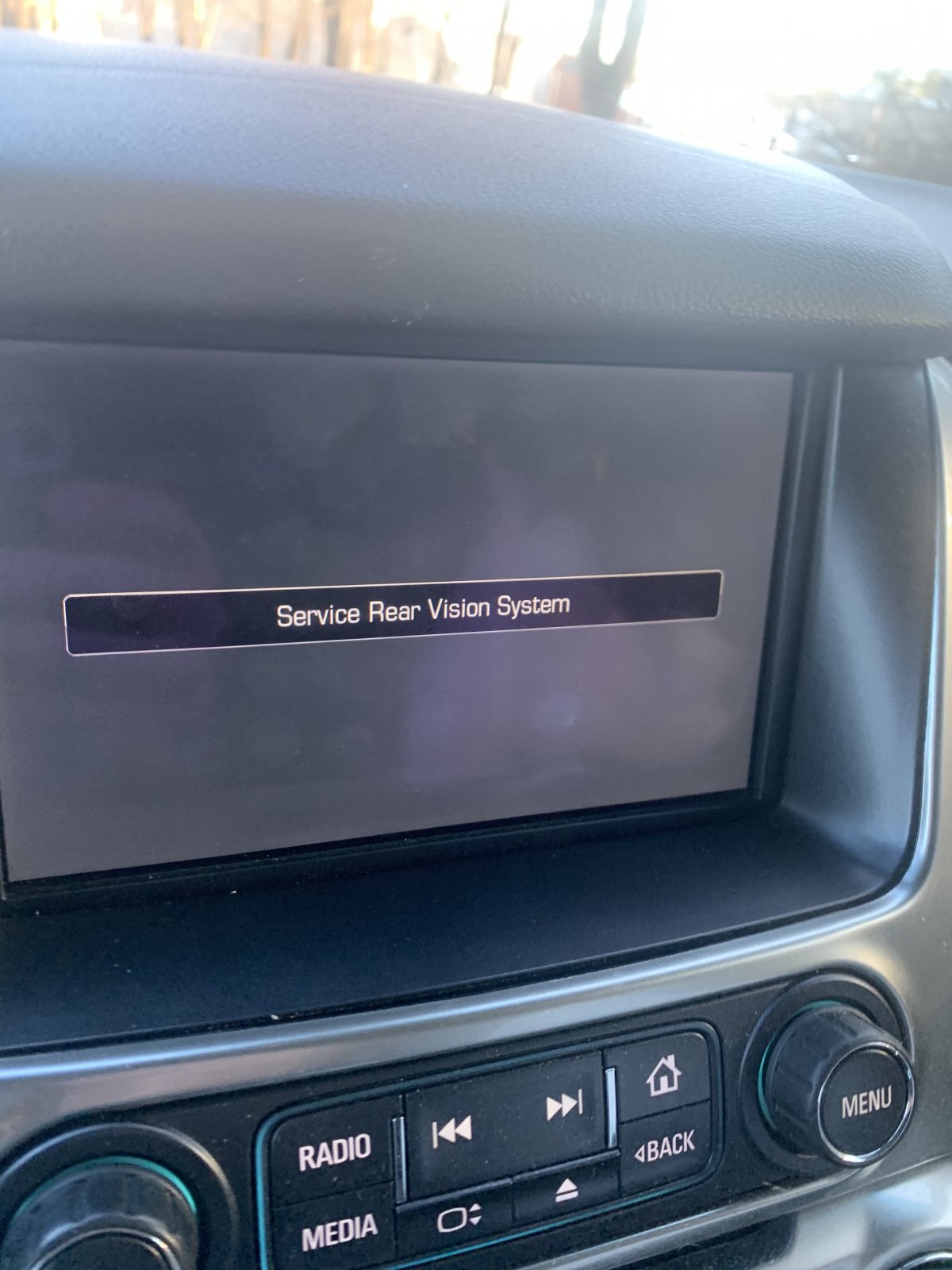

I also get this the be too when I go to back up and the issues appears...

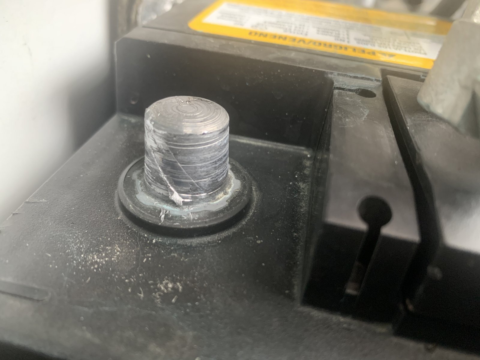

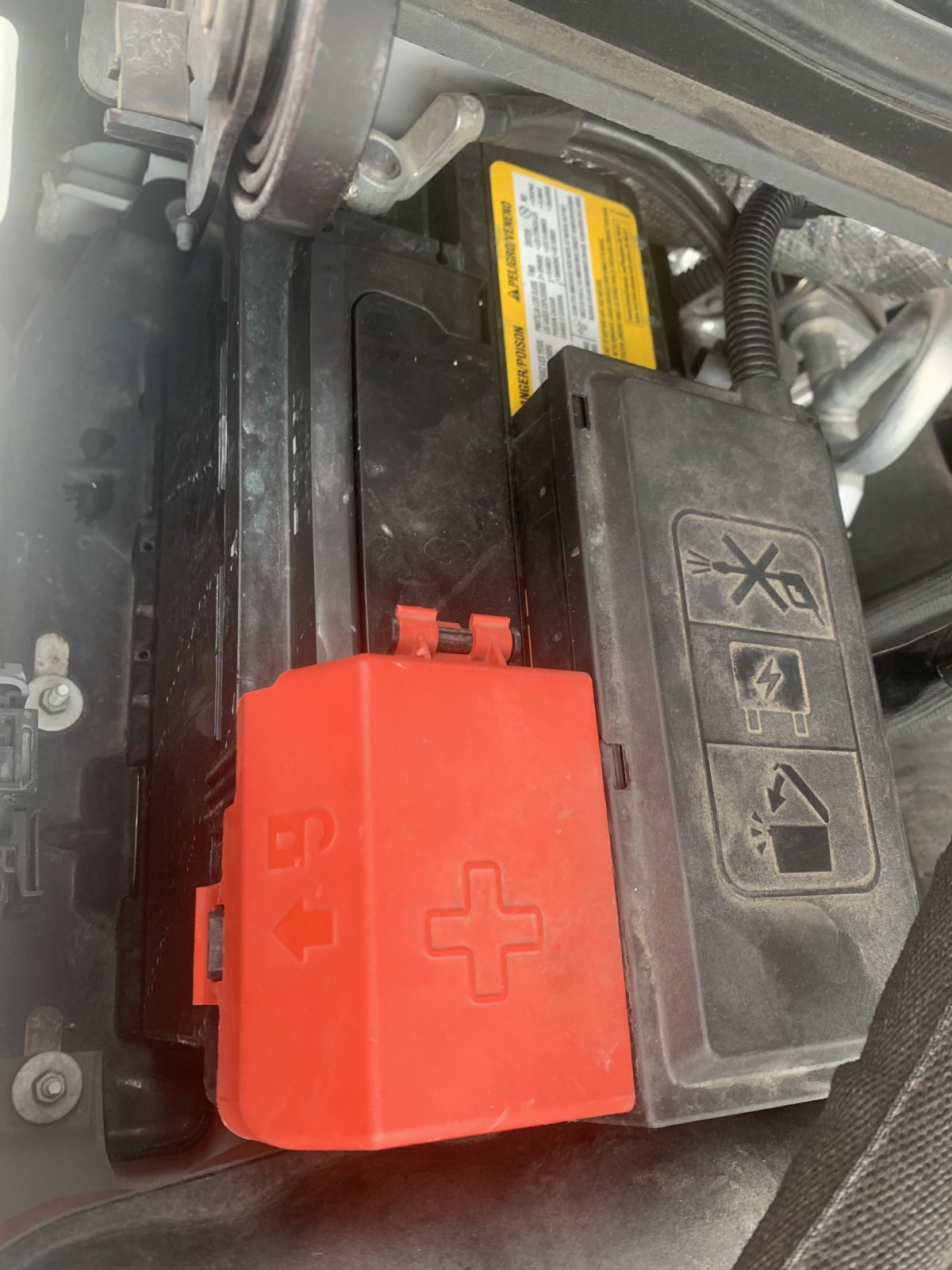

So tonight I unplugged the fuse housing from where it plugs into the lower tray. Also checked the battery connections:
+ Battery > fuse box= good
+ battery > alternator= good
Have not put hands on the plug that is down behind the radiator close to the cross member (red with blue stripe?). All the + battery connections ON the battery are above 12.0
M
MT800
Nov 26, 2020
Battery looks good!

It is definitely a ground/electrical issue. No way in hell all that stuff is going bad at once and it be as random as it is. I would check that ground the guy mentioned with the video in his post. Also since it is affecting the camera in the rear and you mentioned the trailer hitch area, the "power block" that goes into the back of the bumper and comes out where you attach your trailer hook up has been problems for previous people Ive read about. Dirt and water can get up in there and over time rust components or cause arcing of different wire connections at the trailer hookup. If you can get in there and clean it that COULD be part or all of your issue.

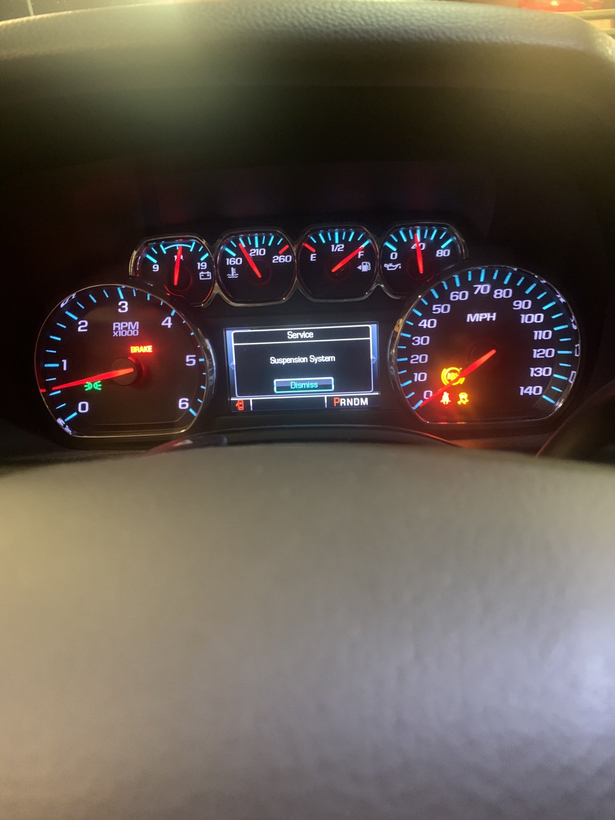

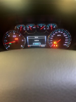

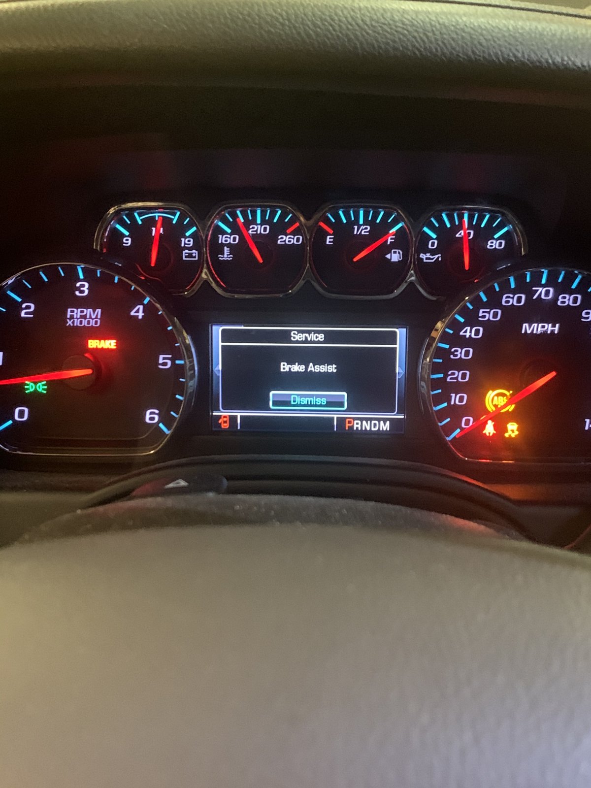

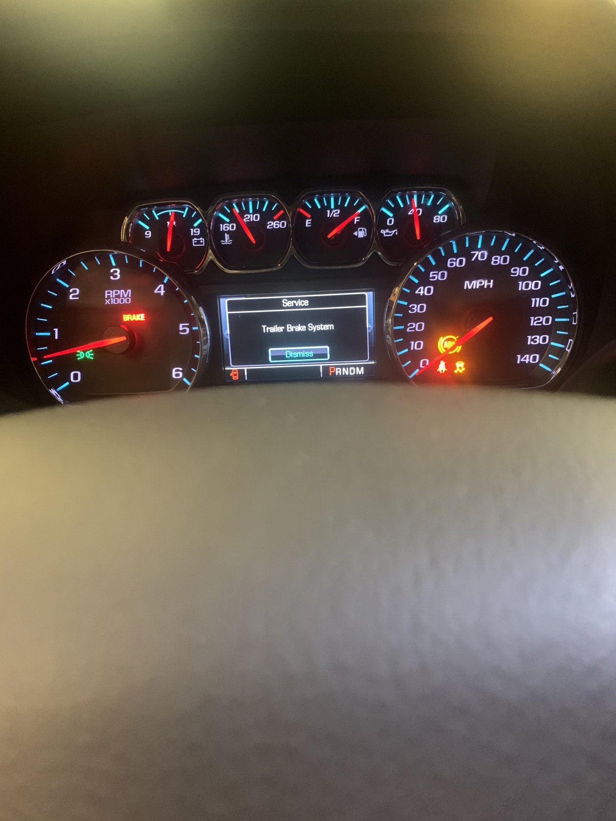

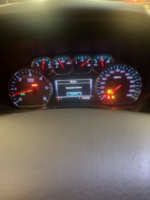

Guess what it’s BACK!!!!! After about a month of working like it should it came back while
The wife was driving. I’m starting to hate this big time!!!

Take it to the dealer since all those are lit up should be easy for them to find, my bet is you either have a broken or frayed wire in the harness or bad ground
a good tech will find it within 2 hours.
