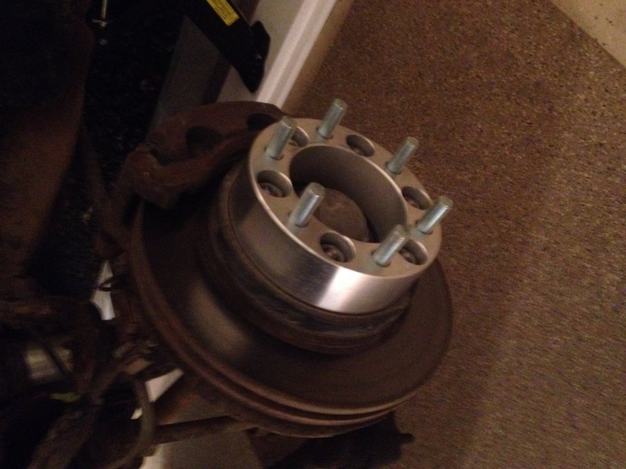

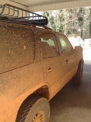

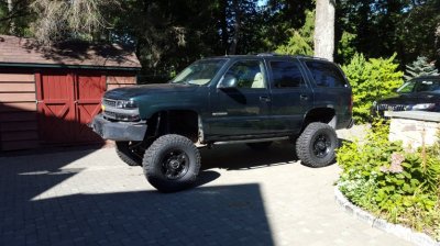

Well nearly seven months have gone by, if that doesn't call for an update, nothing does. It seems I never uploaded pictures of the new wheel/tire combo. So I'll have to post those. Brief aside, the new tires are obviously wider than stock, so they had some major rub issues, especially with the H3 Rims having 5" of Backspacing, So around Christmas time I picked up 2 inch wheel spacers for all four corners, makes life MUCH better, and now I can flex more than two inches without jamming tire into plastic, but I still ended up doing that because I disconnected swaybars when going offroad and that ended up into destroyed wheel-wells front and rear pretty much.

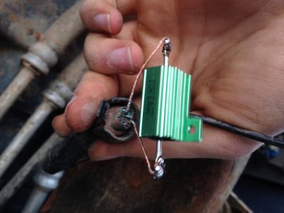

On a modding note, I finally rigged up resistors to make the annoying "Service Air Ride" message go away on the dash, being that i chucked the auto ride crap in favor of bilsteins last year. That was an easy fix. Total Cost, 8 bucks.
Then I decided that I wanted to be able to hear music when I was out of the car, so that led to putting an 800W amp under the center console and running leads to two 6 1/2" Wakeboard tower speakers that I hooked up on the sides of the roof rack.

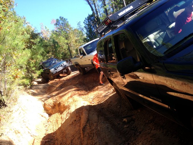

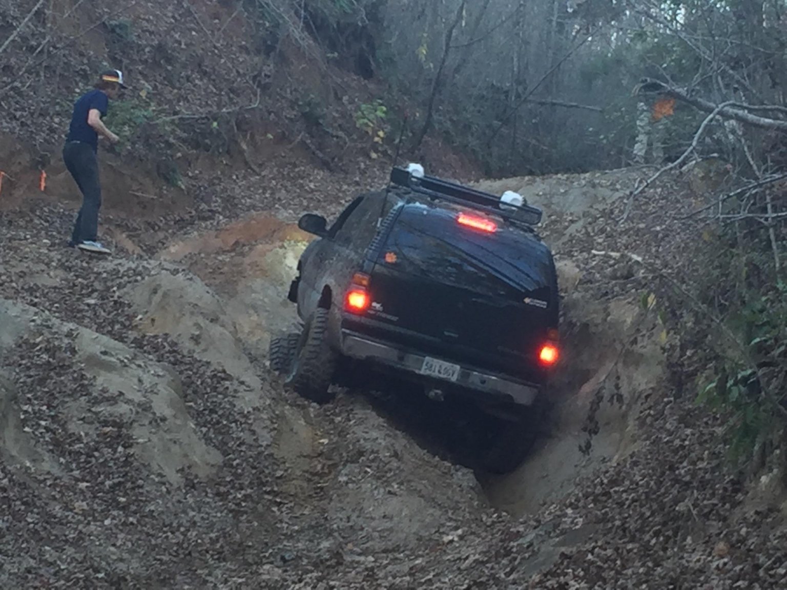

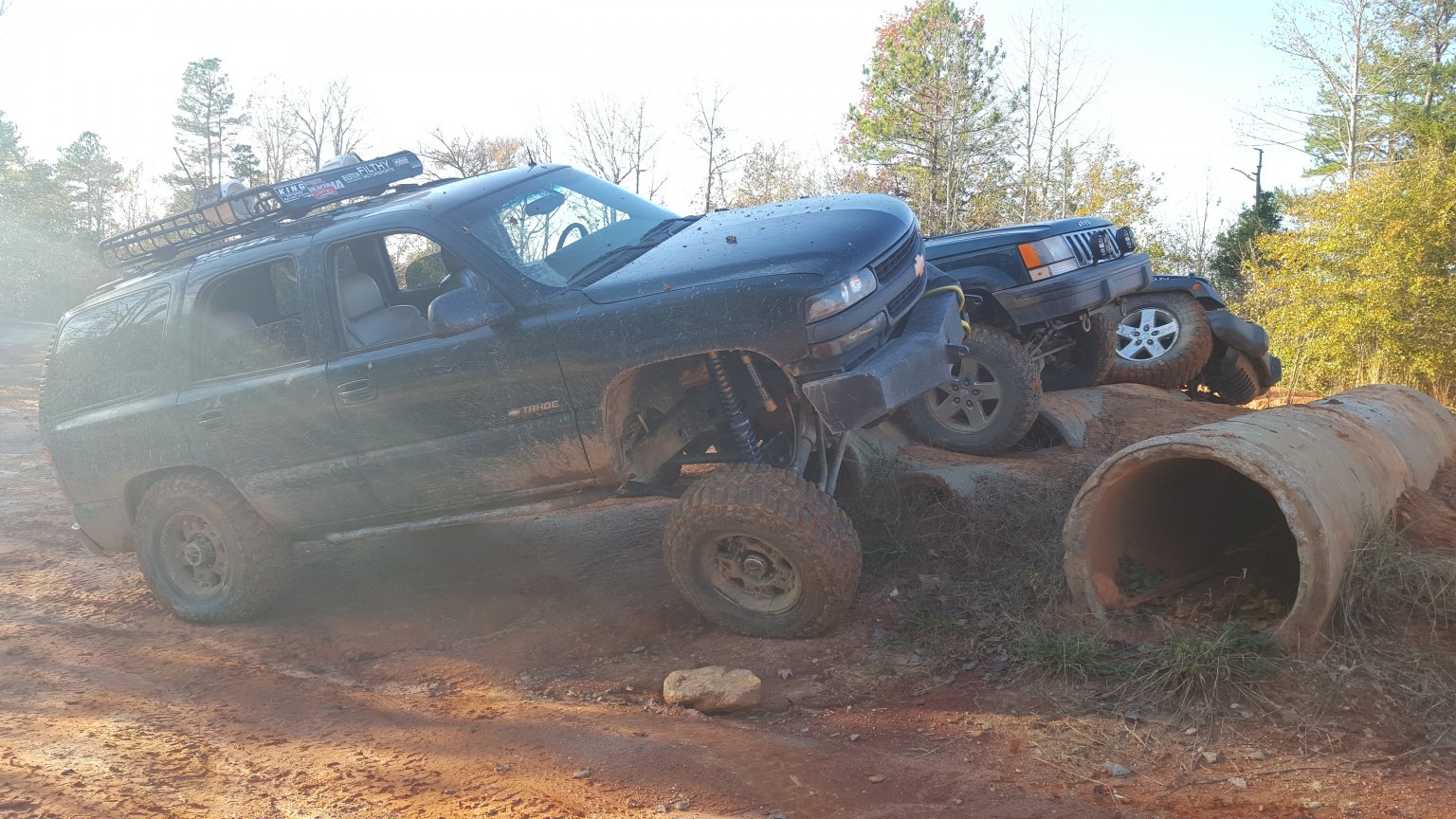

Other than that, it's mostly just a damage report from multiple wheeling trips.
The fall trips I was mostly unscathed aside from scratches all up and down the body, and obviously destroying wheel-well plastic. The Spring trips took a heavier toll, but nothing irreplaceable. Bent one tie-rod, destroyed one of the Trail Can's speaker grill, and trashed the passenger side of my front bumper (will require cutting, re-welding, and then some major gusseting that should have happened the first time I did this.)
Finally, being a Tahoe that spent its first 12 years dealing with snow and road salt in New Jersey, It had developed a nice rust patch on the rear drivers side flare. So i ended up cutting a 5 1/2" by 2" section out of the flare, and welding a patch in, currently just primered black, but I have color matched paint here waiting to go on.

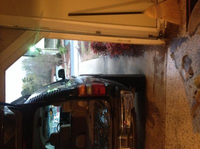

I keep remembering different things that I've done, I also tore out the carpet from the Cargo area. It was ratty and nasty from 13 years of abuse. I'll be putting a weather tech rubber mat back there before the summer starts. I also tore out the subwoofer box and jack stuff from the driver side, It is now totally barren, I have to decide if I want to do a stealth box for a subwoofer, or if I want to do pull out storage boxes.

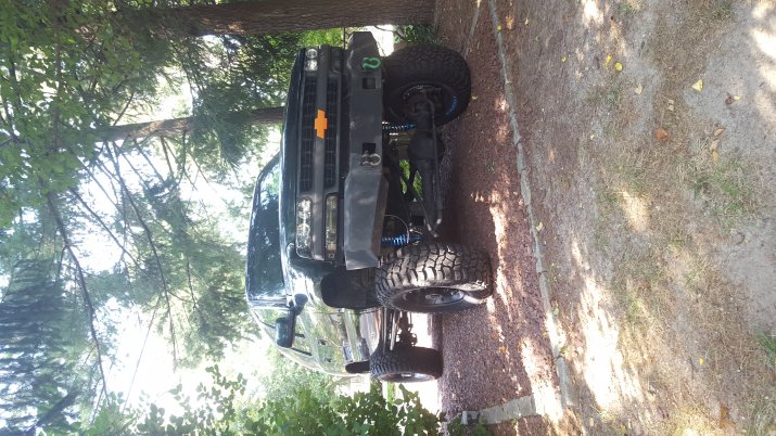

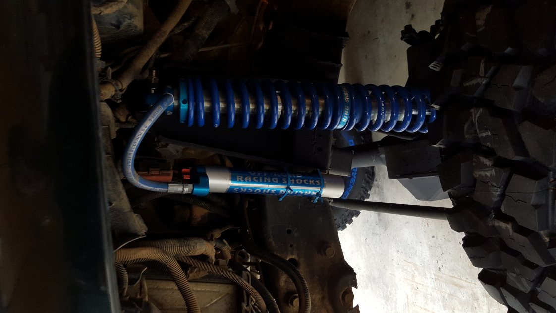

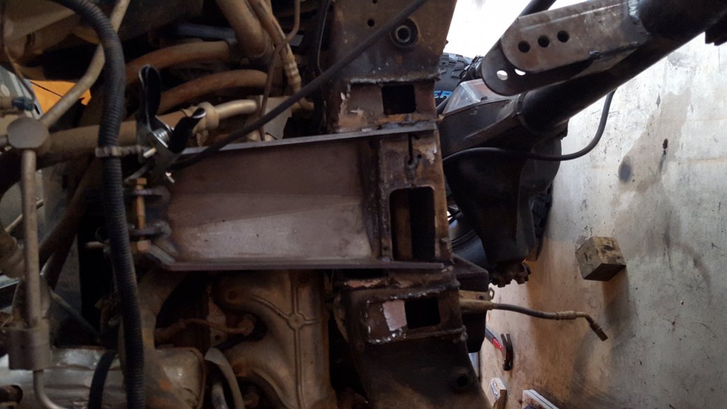

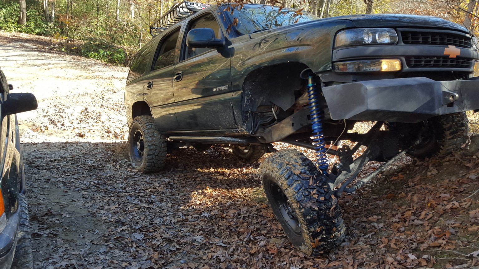

Completed SAS
Got sick and tired of not being able to keep up with the Jeep crowd offroad. IFS just wasn't going to cut it. Clearly wasn't going to sell my Tahoe, oh no, I only wheel in luxury. :jester:
SO, this happened. Dana 60 HP out of an 02' SuperDuty. Three link under 14" Kings. 35" Cooper STT Pro's.
241 TC swap to come soon to regain 4x4. Wheeling trip the 18th to test her out.

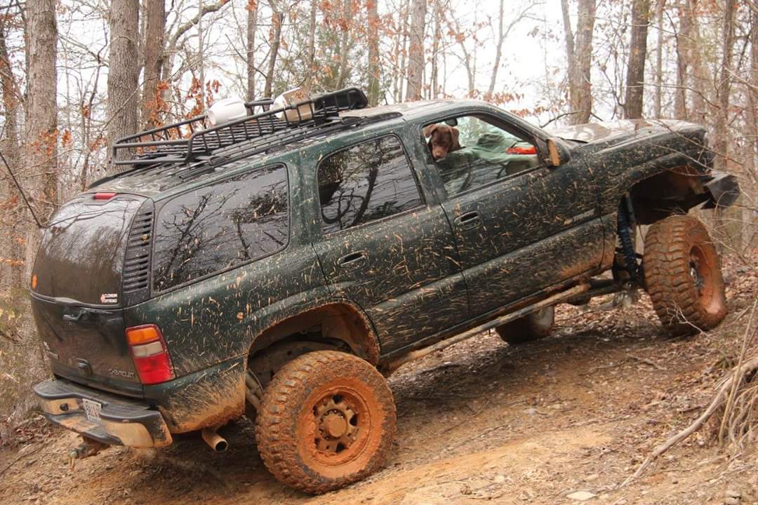

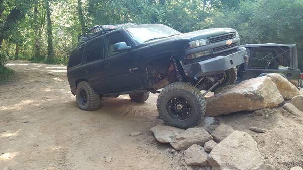

Sneak Preview on Flex.

Ohhh I have some questions for you! How did you do the Coils? Been looking at a lot of build threads of Coiled SAS with no luck. I want to run Coils instead of a leaf sprung since I see it All the time. do you have pics of the build up and specs?
