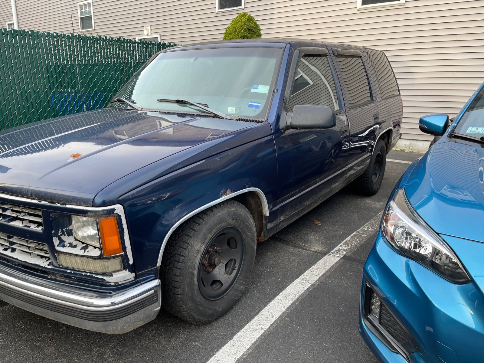

How's it going guys, I recently purchased a 99tahoe rwd PPV. it has the 5.7 v8 with spider injection. when I bought it, the guy told me that it has a hard time starting when warm, also it'll sometimes die at idle because it could be starving for fuel. i replaced the fuel pressure regulator in the spider injection system hoping that would fix my idle problem and warm start. im new to spider injection from the 90's so i was hoping i could get a pointer in the right direction to see if anyone has had this problem. thank you!!

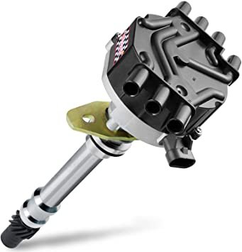

If you pull off the Vortec air plenum, and look all the way toward the back of the intake, you Don’t have one of these?…..

sonofabitch i definitely do have that! i had no idea it was a cap with a rotor! learn something new every day! and it was 250k on it, just bought it, retired highway patrol truck so i will DEFINETLY start with that too. i was hoping to not have to replace the whole spider injection system its like 900 from gm. how easy and is the swap to mpi worth it? ill take all the details you got!

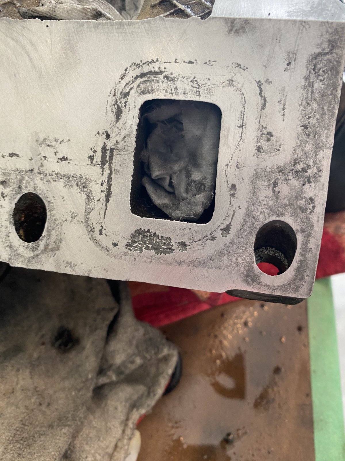

The Spider replacement is a Long weekend project…if everything looks good when it is disassembled. The coolant ports on my lower intake were so badly corroded and pitted, I had to bead blast the intake, and build the surface back up with Metalset aluminum epoxy. These lower intakes are no longer commercially available.
I would say, if you can get the truck running so it doesn’t stall, run it for a while and enjoy the awesomeness of a PPV. After you cruise the town, get underneath the truck and look for coolant drips hanging off the bottom of your harmonic balancer…..now it’s time to think about doing the lower intake gaskets. And while you are in there do the spider. Get the Felpro gaskets, and Felpro sells new lower intake bolts I would definitely get too.I attached a picture with the P/N on it.

It does have a distributor, which is what @YukonGTmaster showed a picture of. Those are notorious for getting moisture under the cap and causing firing issues.
