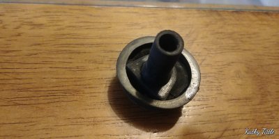

Ok, the vacuum seals you speak of, can you supply pics of them so I know what you are talking about? Where in Oregon are you? I may have a shop contact there that I can recommend.

I can't make out what the pic is about but that does not look like any gasket/seal I have ever seen in a kit but it may be some sort of rubber cap for something I have either forgotten about or have never seen.
Can you supply different angle pics, please?

They are side by side, then inside the other, and the tube one is cocked so you can see down inside to the slotted end. They are hard plyable rubber.
I looked up Vacuum Caps and me say a couple sets in variable sizes.

It looks like the horse shoe shape on the one is shaped that way to hold it where it is mounted at. If they are vacuum plugs, that vacuum leak would be so big that the engine may start but would never idle and stay running. Did they have any oil on them?
Now that I look at the one with the horseshoe shape end, I think that has something to do with the PCV valve at the valve cover.
If you have a vacuum leak at the PCV valve, that can cause the rough idle and dying.

Thank you..no oil on them. I will have my brother look at it. Whatever A pvc valve cover is. Is that near the starter? I hate being this clueless. Lol

No, not near the starter. It is on top of engine and attaches at valve cover and below throttle plate of throttle body with a hose. If that is leaking vacuum there it will have a loud, loud to me anyway, hissing/sucking noise.
