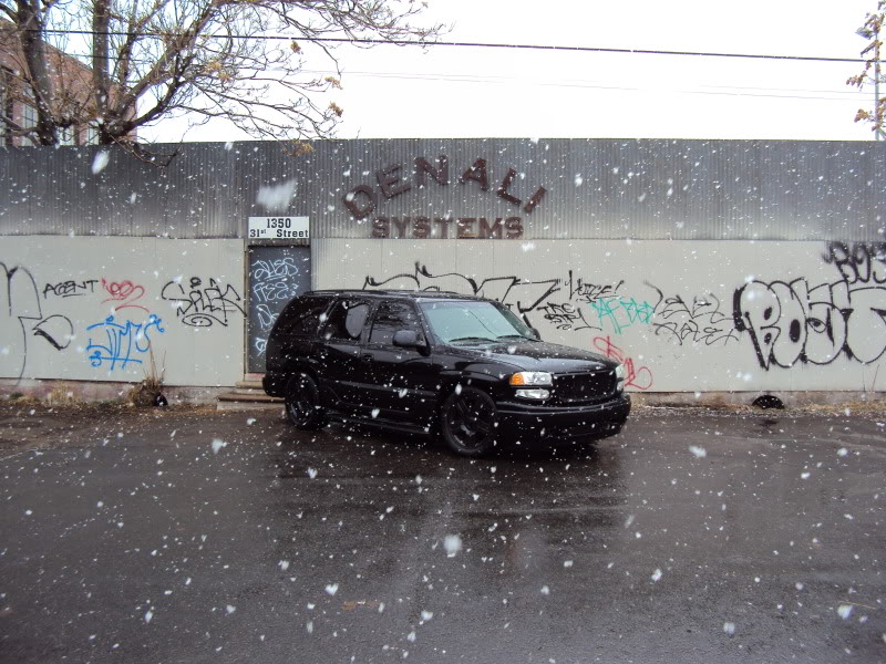

Nope, I'll try to get some pics later this week once the springs settle. I might toss an isolator in one side to make it dead level with 1/2 a tank of fuel.

Looks good in the snowy pic, can't really see the drop amount though. Hopefully you got to a 6" drop.

Not yet, it's about 1/2" away tho. I can tell it's lower since I have about 1" of uptravel on my rear shocks instead of the usual 1 1/2". I should have some shorter bilsteins installed later this week or the following.
