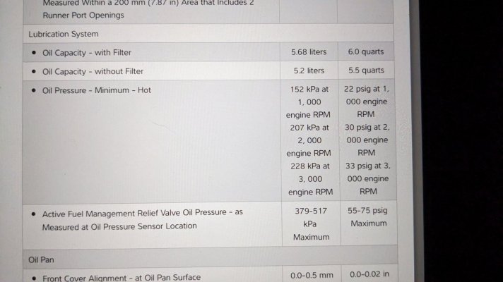

this is going to be different than your truck, this is for the hybrid aluminum 6.0, it's an oddball and uses a veriable displacement oil pump with vanes like the LT engines. but to get an idea of the logic the ecm is using to set the code. if I remember, I can probably find what your trucks specifically looking for.
oil pressure spec hot
36psi @1000
42psi @2000
45psi @4000
afm relief valve 55-75 max.
p0521 ecm detects different oil pressure than expected by lower 6.8psi or greater than 7.3 psi for 10sec

this should be your truck..
