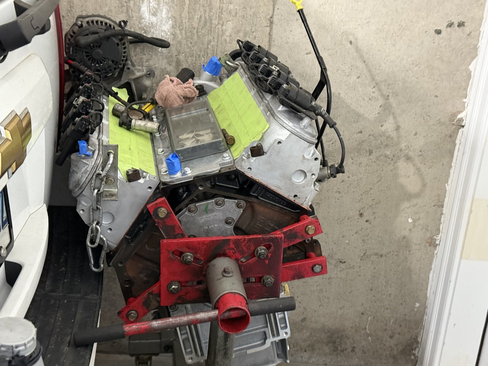

Hi all, first time posting, I have 140,000 on my 07 Tahoe no VVT had to strip it down for a jammed up dod exhaust lifter. This is a daily driver, and I’m looking for something with nice low end power when I hit the accelerator I want it to go, but i also want to cruise in it. I want the whole package, vlom replaced with a block off plate, stage 2 cam, push rods (if necessary), spring kit, roller rockers (if worth it), oil pump (if worth it) upgraded timing chain and sprockets (if worth it) intake manifold, headers, cat back exhaust nothing really loud something quiet till you punch it. I want durability, I want to tow something if I need to, I also want to upgrade the valve body in the transmission I have everything ready to go I just can’t decide on parts what are some of the best most complete kits for DOD AFM delete, and how bout the trans? Trans go? Sonnax kits? Please point me in the right direction much appreciated.

4L60E plastic accumulators and all, none were cracked but I’ve done a few pinless accumulators before and I just want a kit that has everything for the valve body I need without taking the trans out. I have the valve body out already, and have enough work to do with the motor so any complete valve body kit to make the trans somewhat bulletproof would be great.

No drag strip, no racing just an occasional tow, something that can get out of its own way, and something decent on the highway to drive. Dependability, durability, and smoothness if possible

I sincerely appreciate the in depth answer. I’m assuming the transmission has to be removed for this? To be honest valve body work is all I’ve done. I’ve never really taken an automatic transmission apart before. As far as motor work I can do whatever, I just don’t know what the best bang for my buck is ya know? I’m getting rid of the AFM, I have to, i won’t replace it, exhaust lifter jammed up causing nasty, hesitation, popping, there’s no VVT. What’s your opinion on AFM delete kits, Texas speed, BTR? I’m looking for the most complete kit for the best price buying this stuff piece by piece is difficult. I don’t want to go through all this just to put stock stuff back in. I’ll handle the transmission with your suggestion, I read a lot about that kit. I’m looking for a dependable powerful daily driver not a loud monster truck. I just want to put it together and not have to constantly be messing around with it. Does that make sense? Thank you

yes a tune also is needed I know. the main thing AFM delete, just lookin for a reliable stage 2 maybe 3 low lift something for torque , I believe I have 373s
