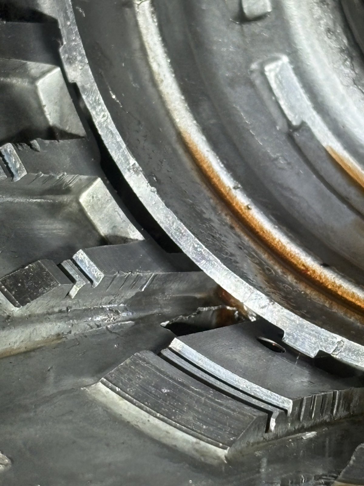

Well this case is toast, isn’t it? @NickTransmissions
