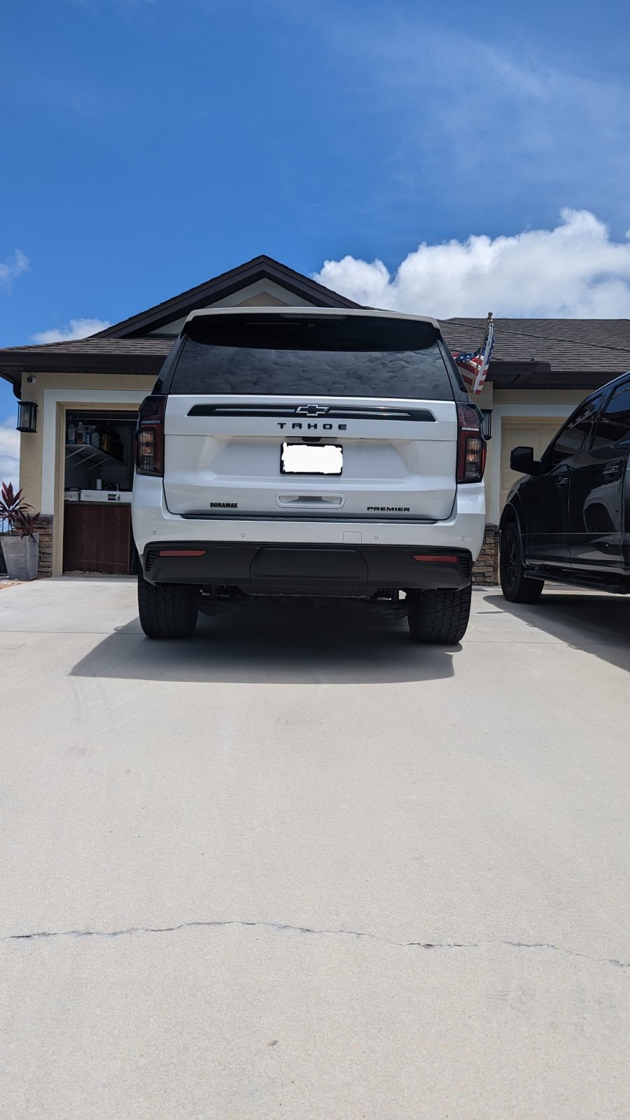

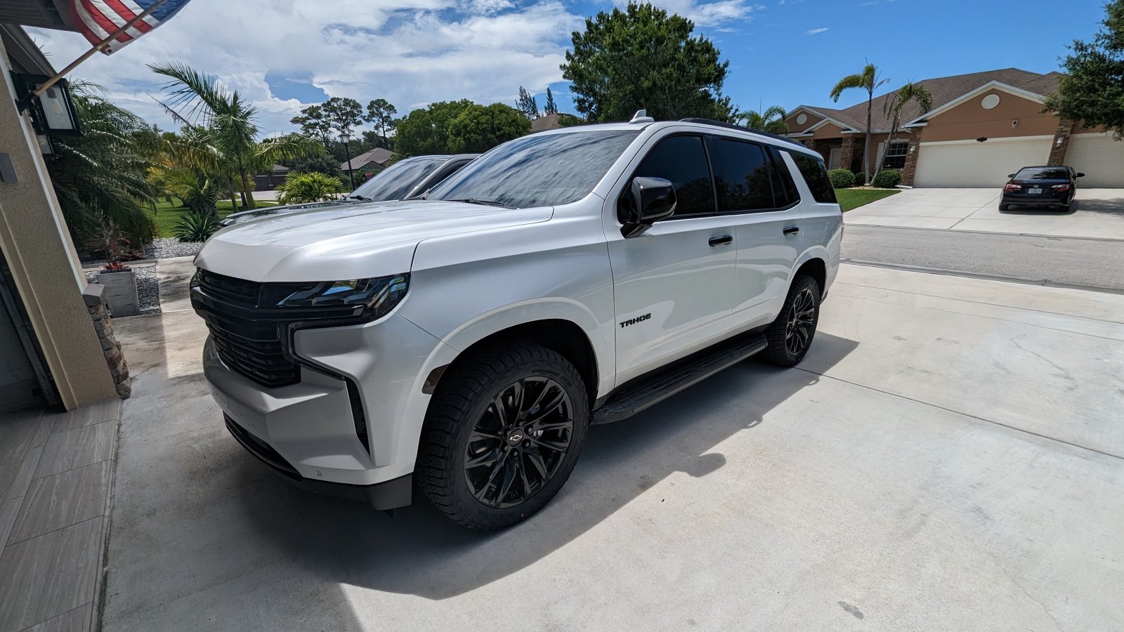

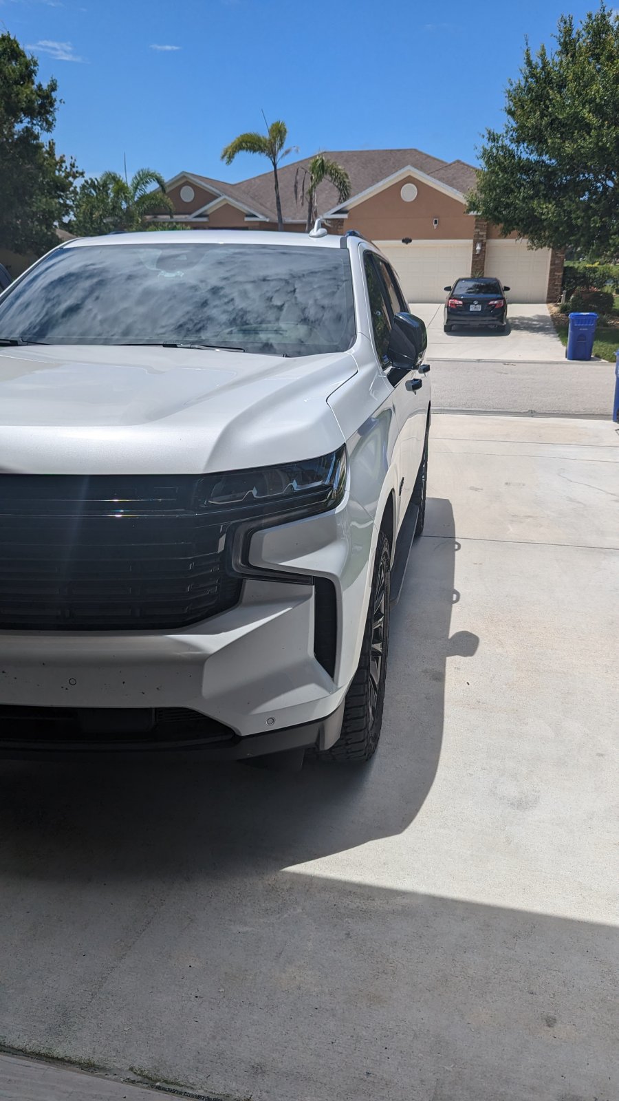

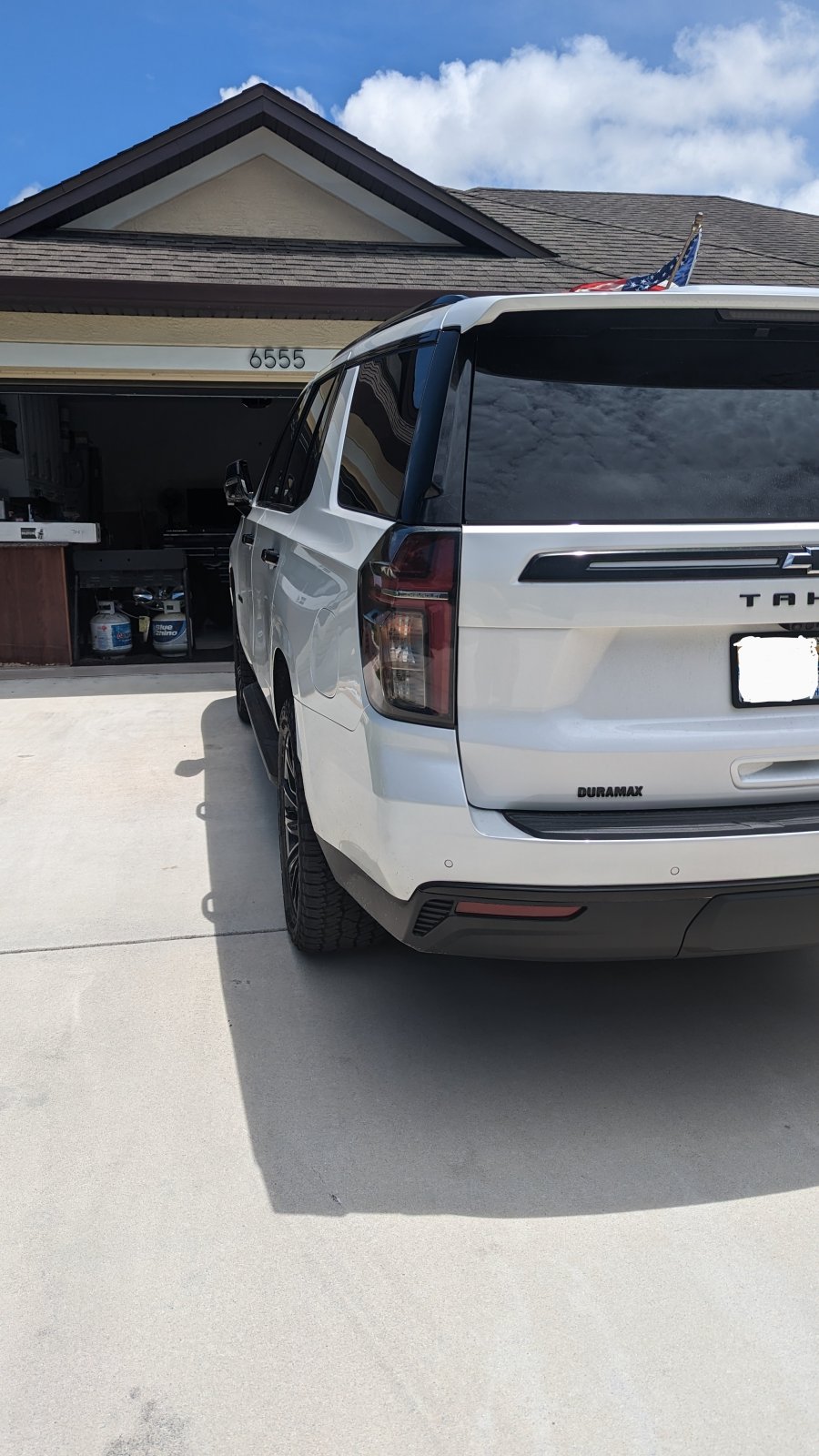

Here is my 23 Premier 4wd w/magneride Duramax with 22x9 +28 (OEM replicas) with 305/45r22 nexen roadian atx. There's no rubbing. She is a little dirty though.

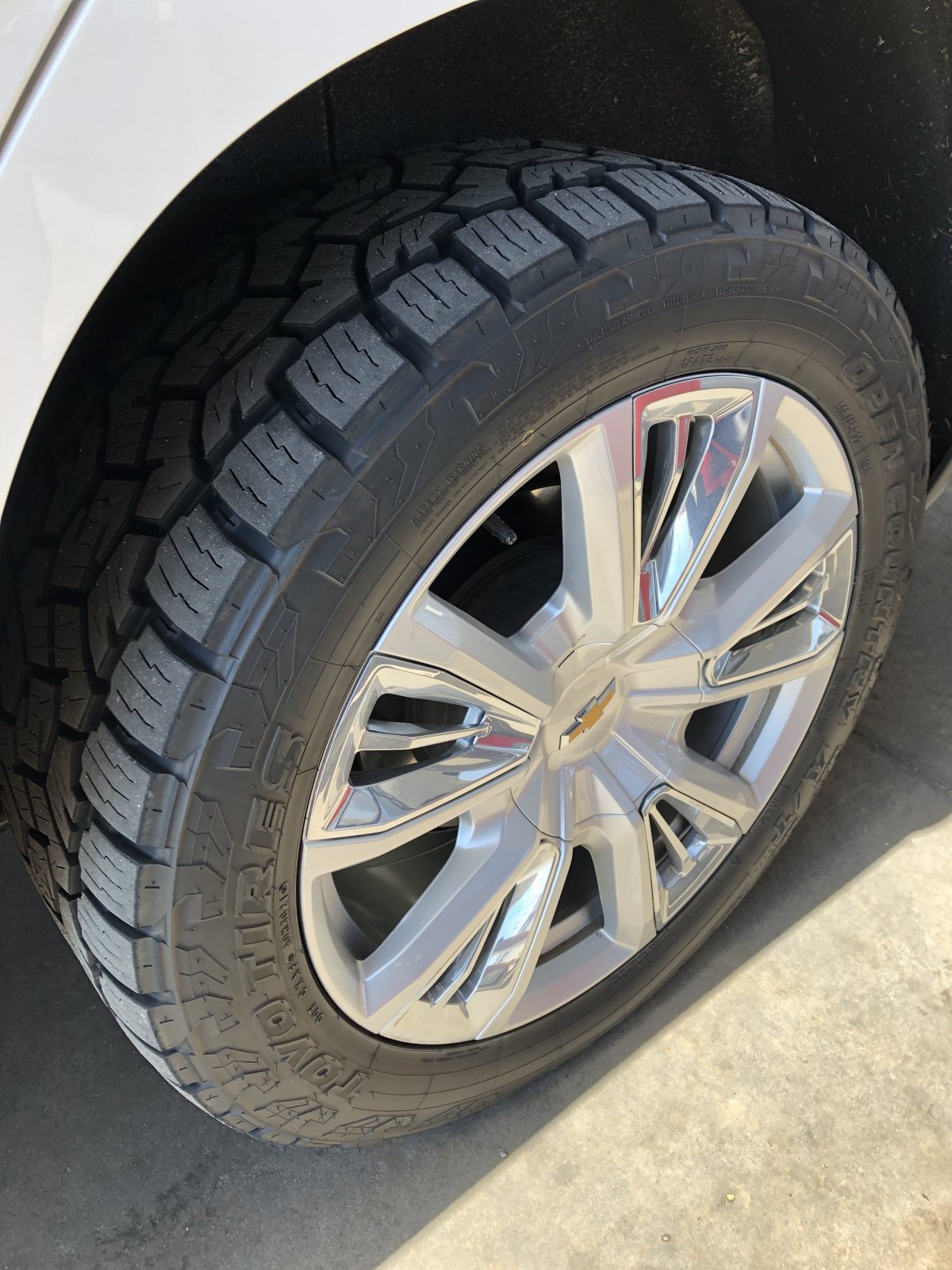

I put 305/45/22 toyo at3’s on a stock high country with stock wheels, no rubbing at all. This is with non air suspension….not sure how it would fair with air suspension in the lowered setting.
