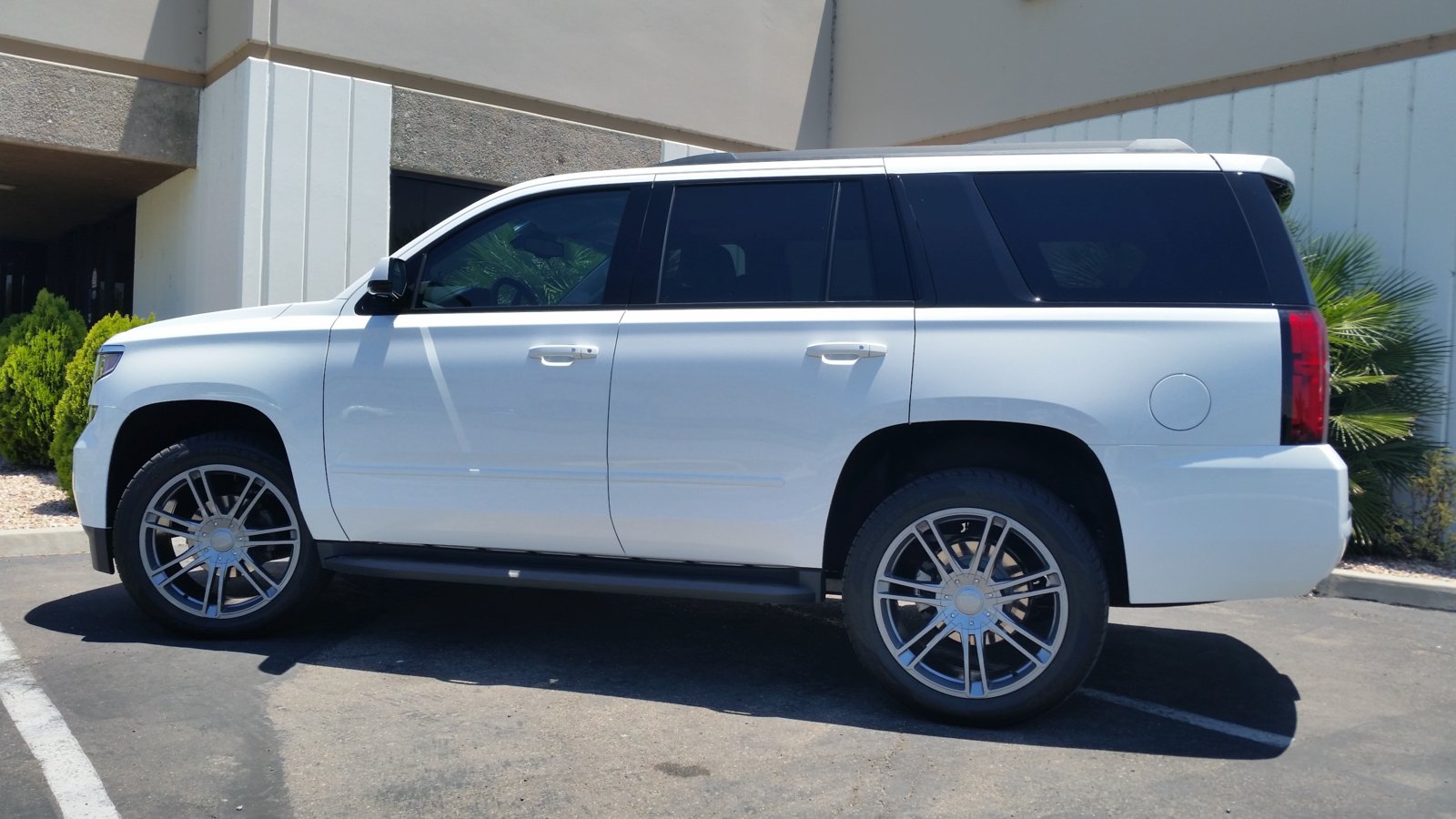

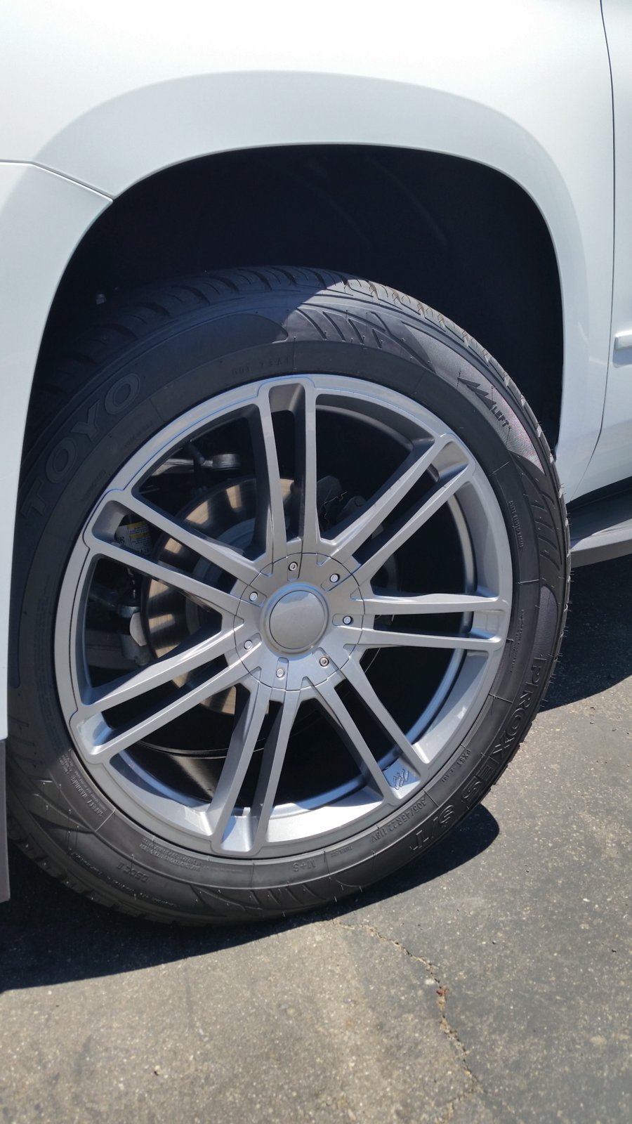

I also did a 4x4 Tahoe for a buddy and did a 22x9.5 wheel with a +20 4x4 with a 305 Toyo, he said his on lock to lock would sometimes rub slightly. We later sold the wheel set to another buddy with a 2wd same body style tahoe and it rubbed considerably more on the inside.
