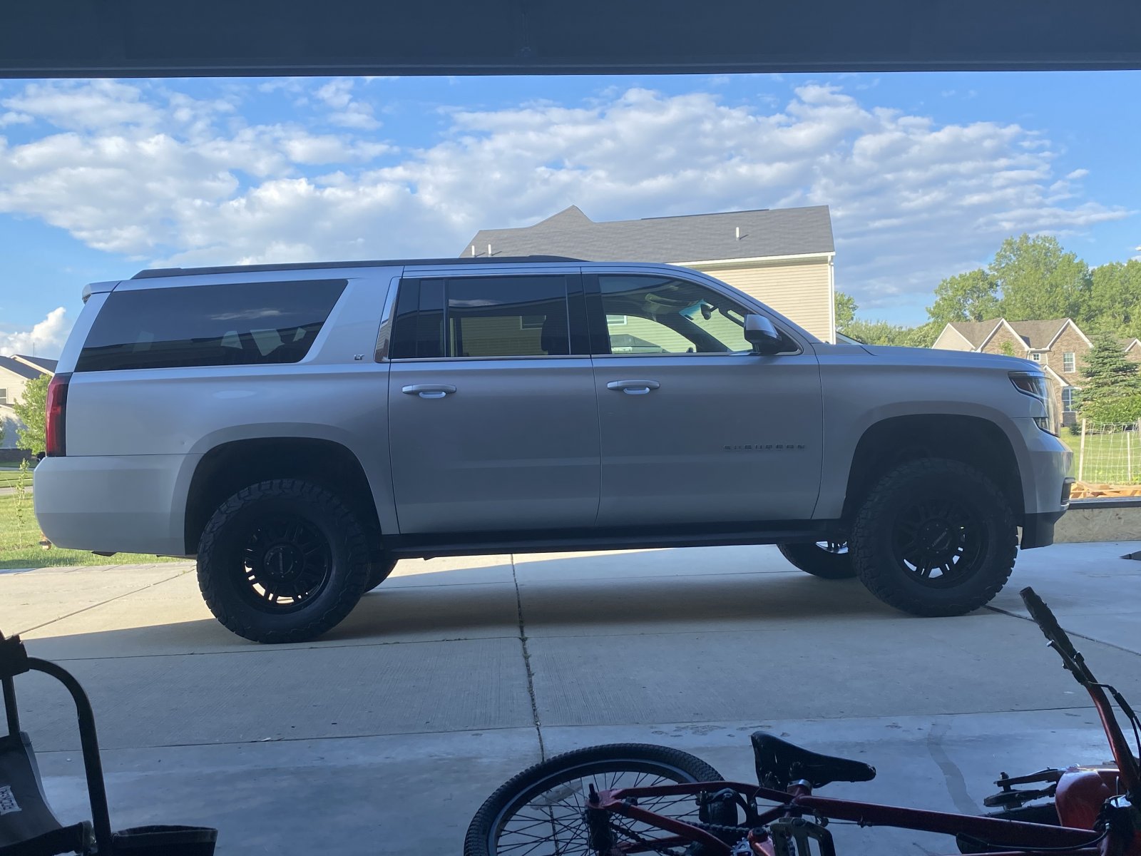

    So we just bought my wife a 2016 Tahoe and I had every intention of putting the RC 3.5” lift on it. Was going to order but noticed in the instructions that the kit won’t work with aluminum knuckles!!!
    Started looking at the Fabtech 4” but then in the instructions it says to drill out the upper ball joint with a 1/2” drill bit.
    So if I have to do that with the Fabtech, could I do that with the RC? RC tech support just said “ball joints won’t fit” so I didn’t know if drilling them out would work.

    I ran into the same issue (2017). I ended up buying the Superlift 3.5 for the 1500 and piecing together a 2 inch rear spacer, shock/sway bar extensions. I’ll hopefully get it on later this week. I tried talking to a couple of reps from RC who were less than helpful. Which is sad I’ve used their stuff in the past.

    Well I finally called RC and spoke with someone instead of chatting with someone online. I was told that the kit now comes with sleeves that will let you use it with aluminum knuckles.

    Let me know how that works out for you. After test fitting some wheels and tires I realized this thing has stamped control arms, which apparently the RC kit doesn’t work with those either
