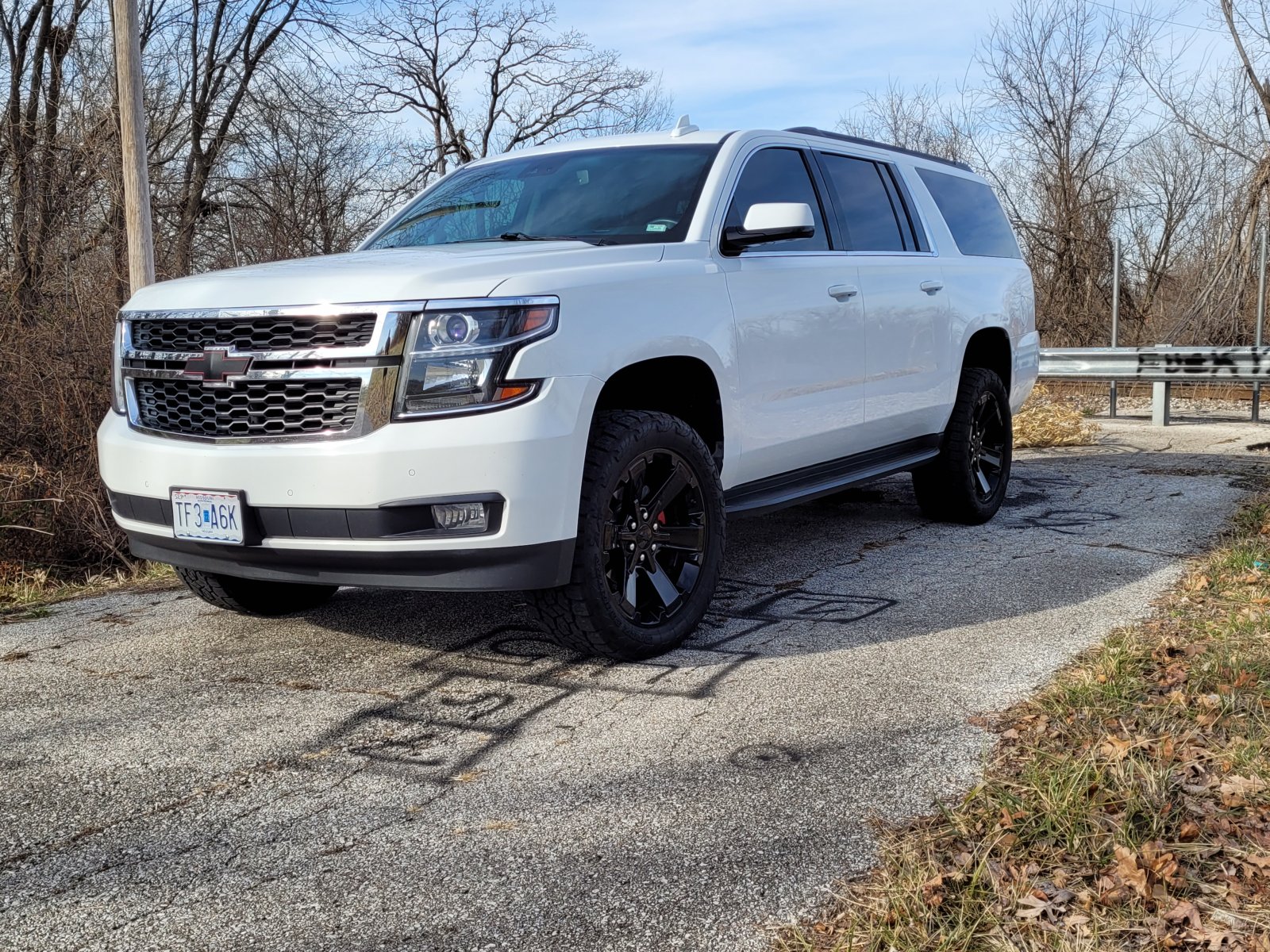

What 3” lift did you go with, I LOVE the look of your setup!
Thank you!! I think I finally have it set right In this picture I have a 3” level spacer and with Z-71 rear springs/2” spacer combo and nitro shocks. 18x9” KMC granite wheels 30 offset 1.5” spacers and 275/70R18 Goodyear duratracs.
I updated my mid-travel post on here and now I run a Fox 2.5” remote reservoir coil over with Dirt king uniball upper arms with no sway bar.
18” KMC impact wheels 0 offset and Goodyear territory in 275/70R18 size.
