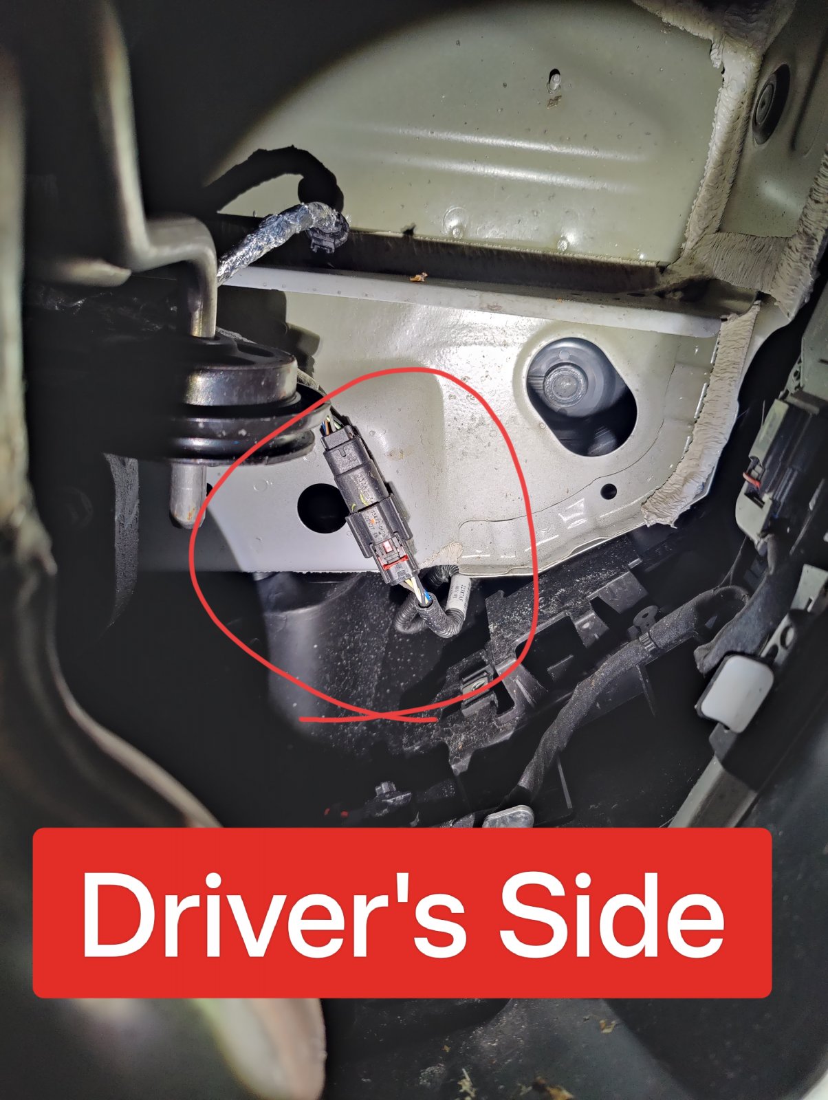

I just want to confirm that these are connectors for the harness you plugged into on the Tahoe.
Also, on the drivers side, coming off the connector, there another leg that has a 2 pin connector that connects to nothing.
Do you know what this 2 pin is supposed to connect to?

@Tenscourts
Those are the connectors and I have a guess on the 2 pin but I'm not 100%. The Yukons have brake lights that extended into the liftgate. I believe the 2 pin may be where the wiring to trigger those brake lights connect but it's only a guess. I have the empty 2 pin as well.
