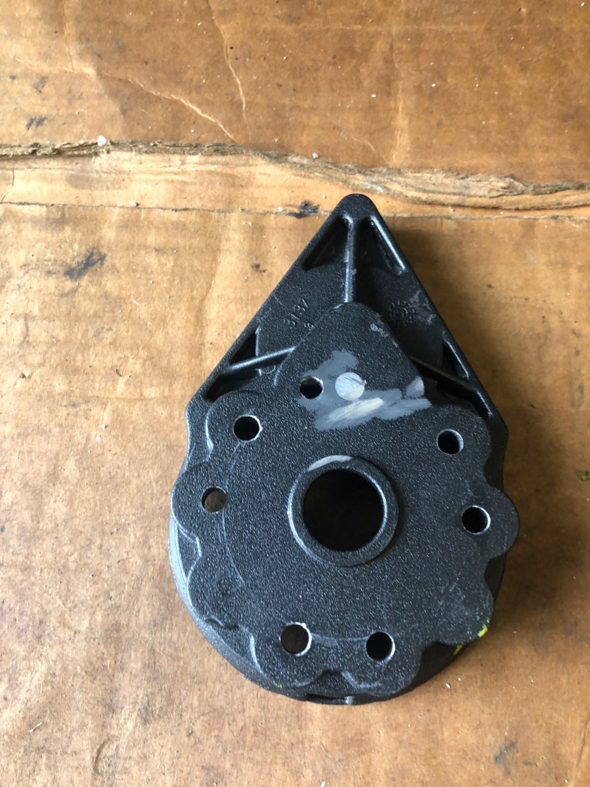

"After losing several hours on this install on my ’22 Tahoe I came up with two passenger side motor configurations that will work without unclipping and moving the rear AC lines (which I’d strongly suggest not be the approach).
Pic 1 worked but motor is hanging down in harm’s way. I get into deep snow at times and believe the motor could eventually become damaged.
Pic 2 was close but end of motor did clear the frame by about a 1/16”. Tahoe wiring harness that runs along the frame had to be unclipped to run around the outside of the motor but seemed to have enough slack to comfortably go around it. I chose this configuration as the motor is protected.
I did have to grind the small nub in Pic 3 off the back of the gear housing. Assume that adds strength to the connection between the gear housing and linkage arm due to the stress on the bolts the motor torque will apply when cycling repeatedly over the years.
Considering I removed the nub and made swiss cheese of the gear housing having to drill additional holes I would like a replacement passenger front linkage arm please once AMP determines the best configuration for this."

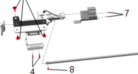

It also took me a minute to figure out the wires. The instructions reference the Light Gray BCM plug, but I had to trace the wires back to realize they should have said Dark Gray.
I noticed there was a revision to the instructions online vs the paper copy I had, most had to do with wiring. The online instructions seemed to jive with what I saw on my Tahoe.
