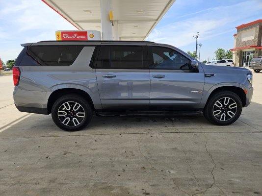

Curious if anybody fit a 275 65 20 on stock wheels? Thanks!
I am trying to figure out too, I need tires on my wife's Yukon AT4 without air suspension, can't get a straight answer

Just installed 275/65/20 with stock wheels and no lift. So far it rides great and no rubbing, the tires are Kanati Trail Hogs. Might get a little rubbing on rough turns but haven’t felt it yet!
That looks great! What tire is that? Do you think a 285/65/20 would fit? Another 1/2 inch taller than 275/65/20 (34.1" vs 34.6")

Yes I’ve got Landspider WildTrax 275/65R20’s much better off-road and fill the wheel well much better. I have stock suspension and only slight rubbing at full lock over bumps. Never heard it only see after.
Would a 285/65/20 fit you think? 275/65/20 is 34.1", I am wondering if 275/65/20 is the tallest possible on a stock AT4 Yukon without air suspension or if a 285/65/20 (34.6") tall will work with stock height and stock wheels.
Since you are keeping the stock wheels it makes things a little easier…especially when you are not going with wide tires. Turn the wheels through the range of motion and evaluate how much room you have before rubbing the liners/fenders etc…there will be a few areas where it hets tight, which is where you have to look out for. Simply see how much room you have and go from there.
