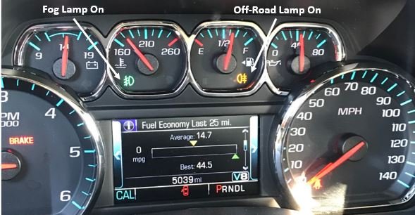

I have a 17 Yukon SLE with Factory RPO T3U Fog Lamps and wondered if the Off-road lamp indicator might be incorporated into my cluster?
This is a capture from the video (2500 Denali) and I added the switch image which illuminates in blue:
Next question, Would BCM have to flashed to turn on the Off-road Lamp portion of the switch?

Did you checkout the youtube video on the Denali 2500 install?
I answered my own first question - the Off-Road Indicator in right below the fuel symbol.

Doing a little more searching out on the interwebs I think the image of the GM switch in your post is the correct one, but the part # you reference is for the "normal" one with the fog light button only.
I believe the correct part number you would need is GM #84448506
The image shows the bottom half of the circle part of the switch split into two buttons; 1 for fog lights and 1 for off-road lights.
The part number for that switch is for a 2018-2022 Chevrolet Colorado.
I imagine you'd have to find the pin-out on the back of the switch plug that operated the off-road light button and see if the factory harness plug even has a pin/wire for that location. Assuming if not, you'd have to add that wire/pin to the factory lighting wiring harness.
Maybe @cmatt could lend a hand or shed some light on how to or what would be involved to activate this function of that OEM switch on our SUVs?
