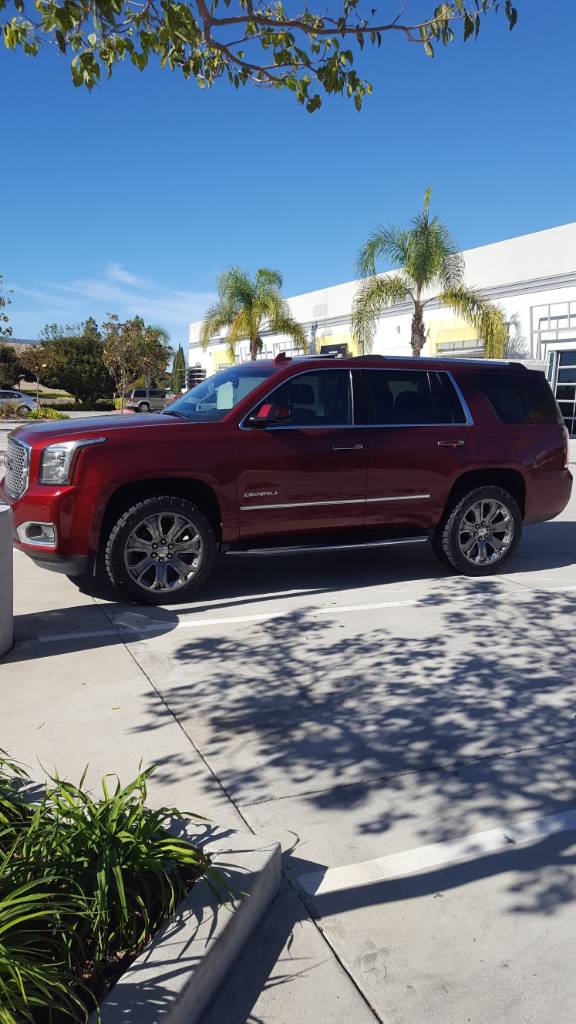

Really happy with how everything came together. Was able to squeeze 33x12.5x22 Nitto Ridge Grapplers on there.

That looks really good. I've got a black yukon SLT 2017 with factory 22 wheels and 285 tires. I'm looking to beef it up a bit with bigger tires but it looks like I need to level it first. This that a 2inch level kit on yours?

I have the adjustable lift, only set at 1.5".

Hey Jennabear, so you got the suspension maxx level kit and only raised it 1.5" and was able to fit 33x12.50 with no rubbing or trimming?
Thanks!
edit: Just wanted to double check because I am about to pull the trigger on the level kit and want the same setup for tires.

At full lock there is slight rubbing.

How bad is the slight rubbing? Wondering if I should go 2” front lift with the suspension max kit and if it would possibly make a difference?
