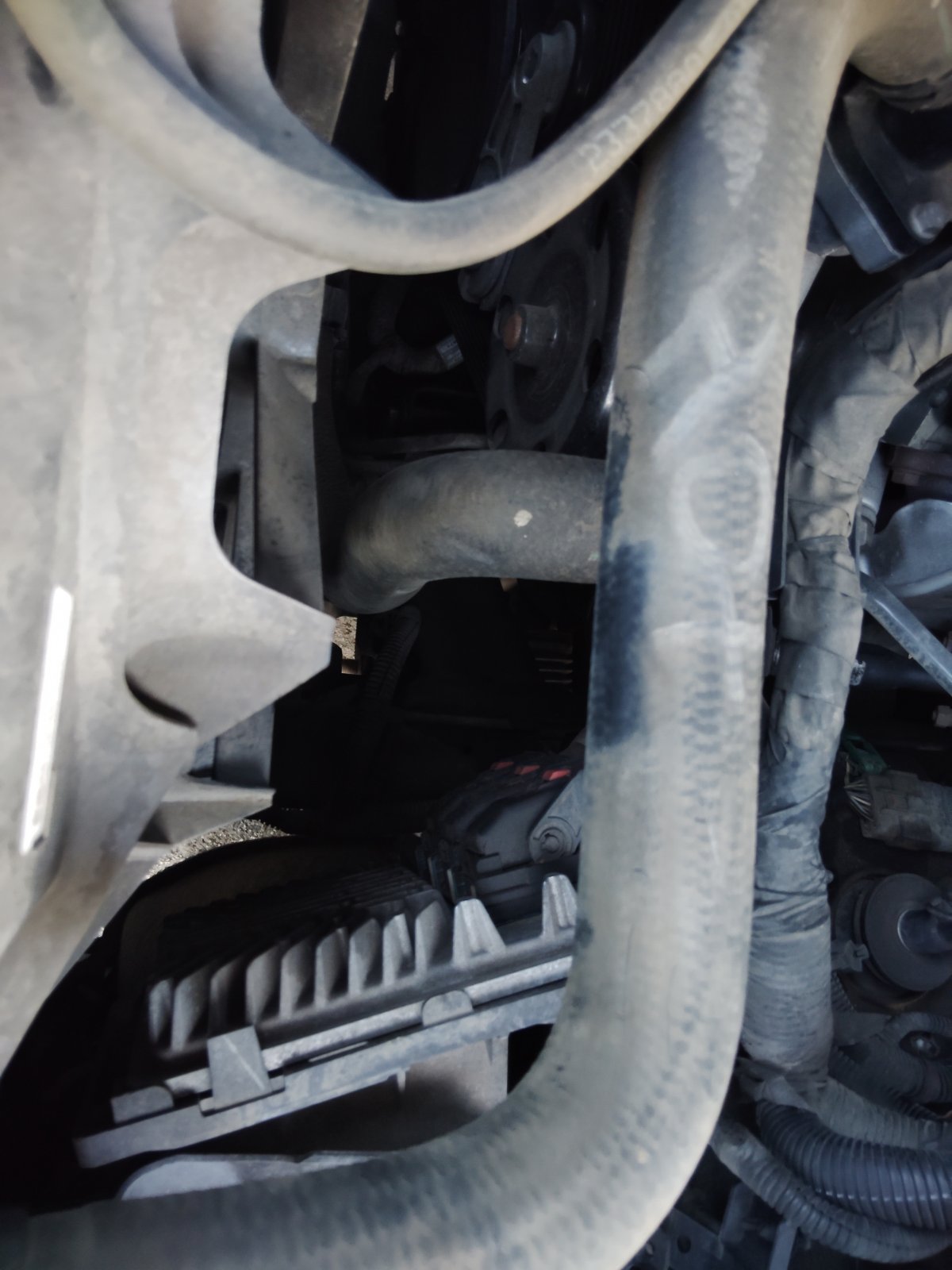

The top ones hot bottom one is not really hot warm but definitely not hot
