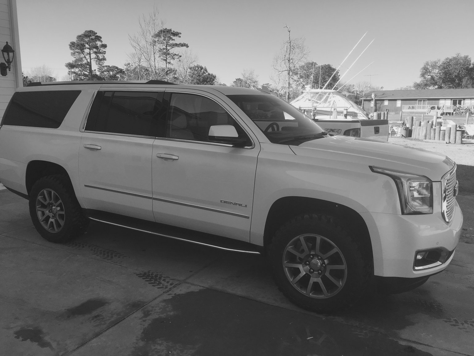

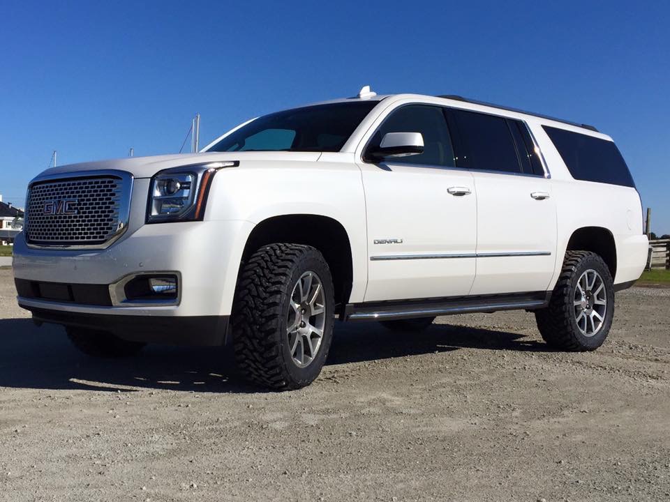

thought a picture would be worth sharing..
2016 Yukon XL Denali
White diamond tricoat

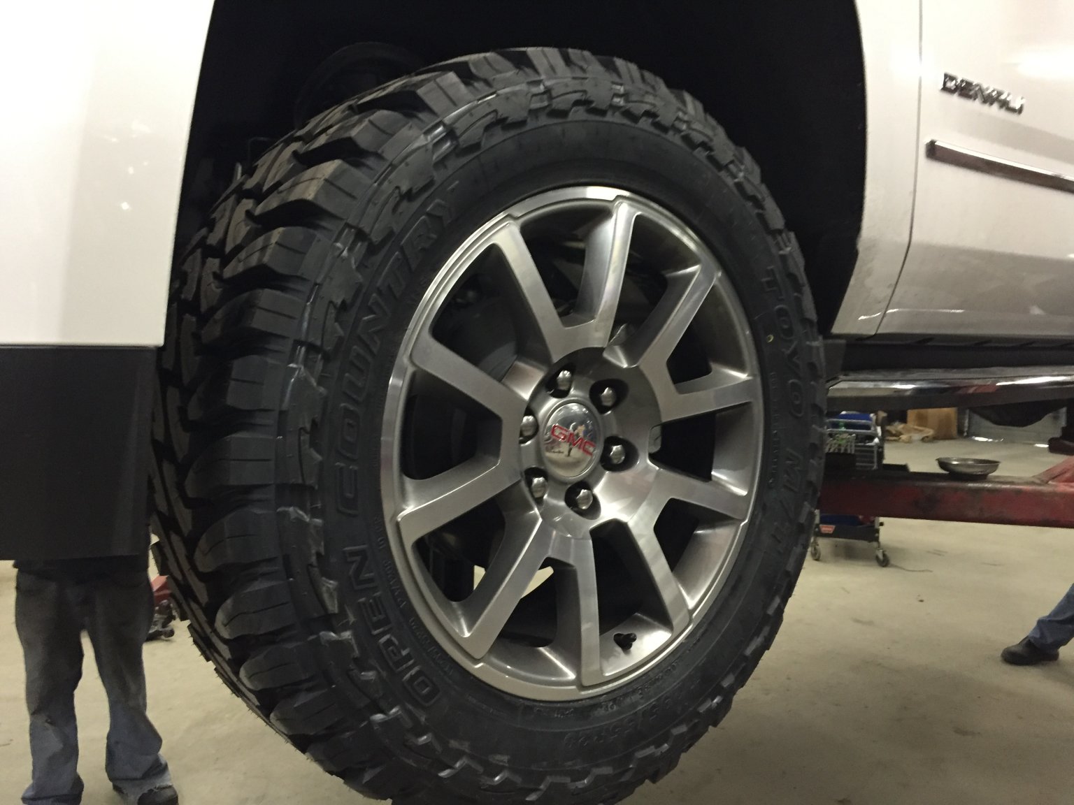

Custom Down East Off-road leveling kit (2.5" front 1.75" rear. Autoride brackets)
Toyo M/T 295 60 r20
Turned out nice. Gonna give it a few miles to see how the ride is...the higher sidewalls should be an improvement

Love it! Perfect stance IMO. Just the way I'd set up my SLT.

Any rubbing whatsoever
The guy with the silver one setup on 2.5/1.5 said he got rubbing in reverse
That prevented me from going bigger than 1.5 in the front on 275/60/20s

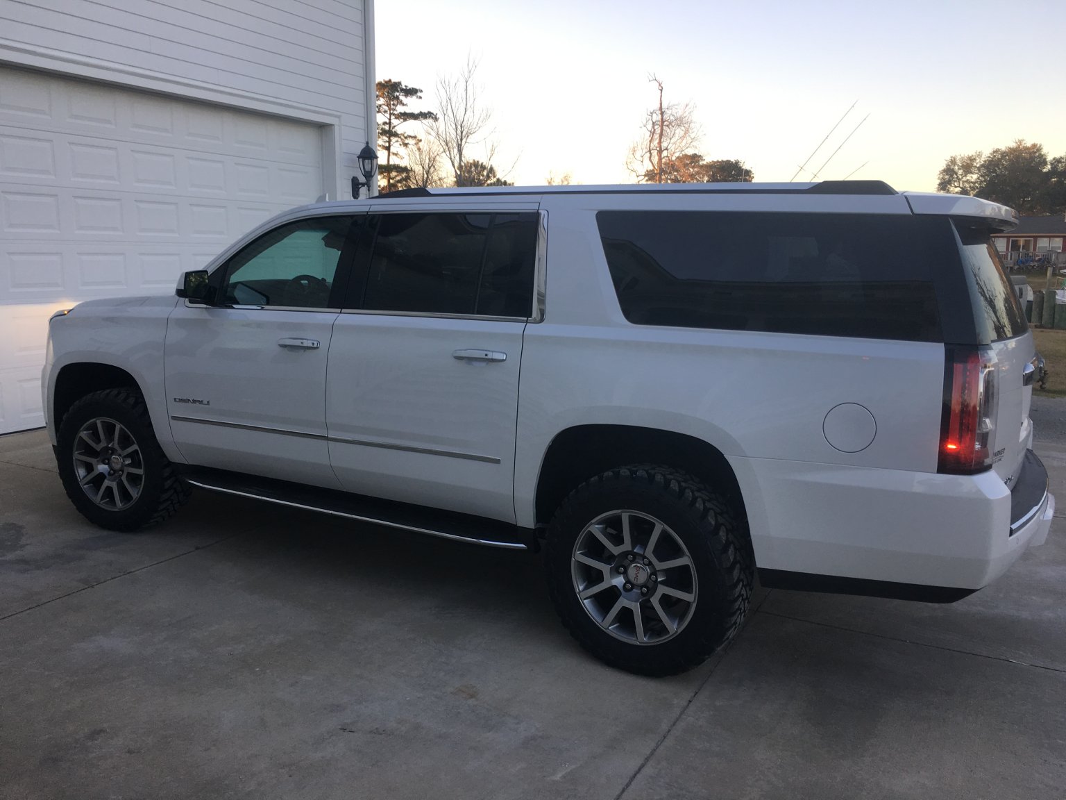

I have just gotten back to town and have had a chance to drive it some more. Ride is good. Tires are a bit more noisy than stock ones, but I knew that would be the case with such an aggressive tire. With the radio on, it is not noticeable.
I got a couple of side shots, but was almost dark today when I had a chance to do so.
Truck is a 4x4
No rubbing that I've felt or heard
No fender trimming done.
