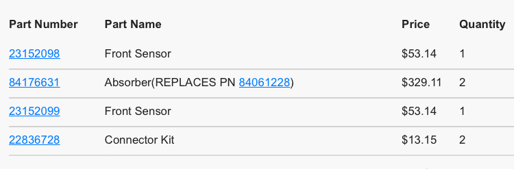

I brought my 2015 LTZ Suburban with MRC in for a rough ride concern....they mentioned both front struts were leaking and replaced under warranty @ ~32,000miles.
I have to say, the ride is greatly improved. I did think it was interesting that the new Front Strut part numbers have been updated, replacing the Front Strut part numbers that were originally installed. My truck was built 7/2015.
