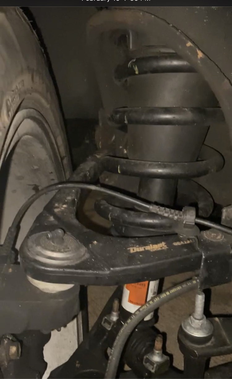

Except the upper and lower front control arms. Duralast Gold from Autozone is better. They cost 15-20% more. When you compare the OEM and the Duralast you will see what I am talking about.The Duralast has lifetime warranty and zerk grease fittings. I also would only use the Duralast AGM platinum battery from Autozone. If the battery fails you could drive to any autozone and get it replaced on the spot. Autozone will let you use there tools or change it for you too. I made the mistake by buying a Delco GM gold 40 month battery and it failed 9 months later. I was stuck and had to wait for roadside. I thought maybe my battery needed to be charged so I drove it and again I have to call roadside x2. In order to get my battery warrantied I had to bring my Escalade to the Cadillac dealer that sold me the battery and leave it for a few days. I was out of town so I wasn’t able to do it so I just purchased a Duralast just to be done with it. So I basically threw away $220 by purchasing the Delco Gold. It was a hassle to get it warrantied and didn’t want to keep calling roadside everywhere I went. This happened on a Friday night so the dealer wasn’t open till Monday which meant I had to keep jump starting my truck throughout the weekend putting my truck as risk and possibly breaking the computer or something else. The Duralast AGM battery is awesome. I had it for almost a year. I am very happy and it has great reserve. I like the way it looks in my engine compartment too.

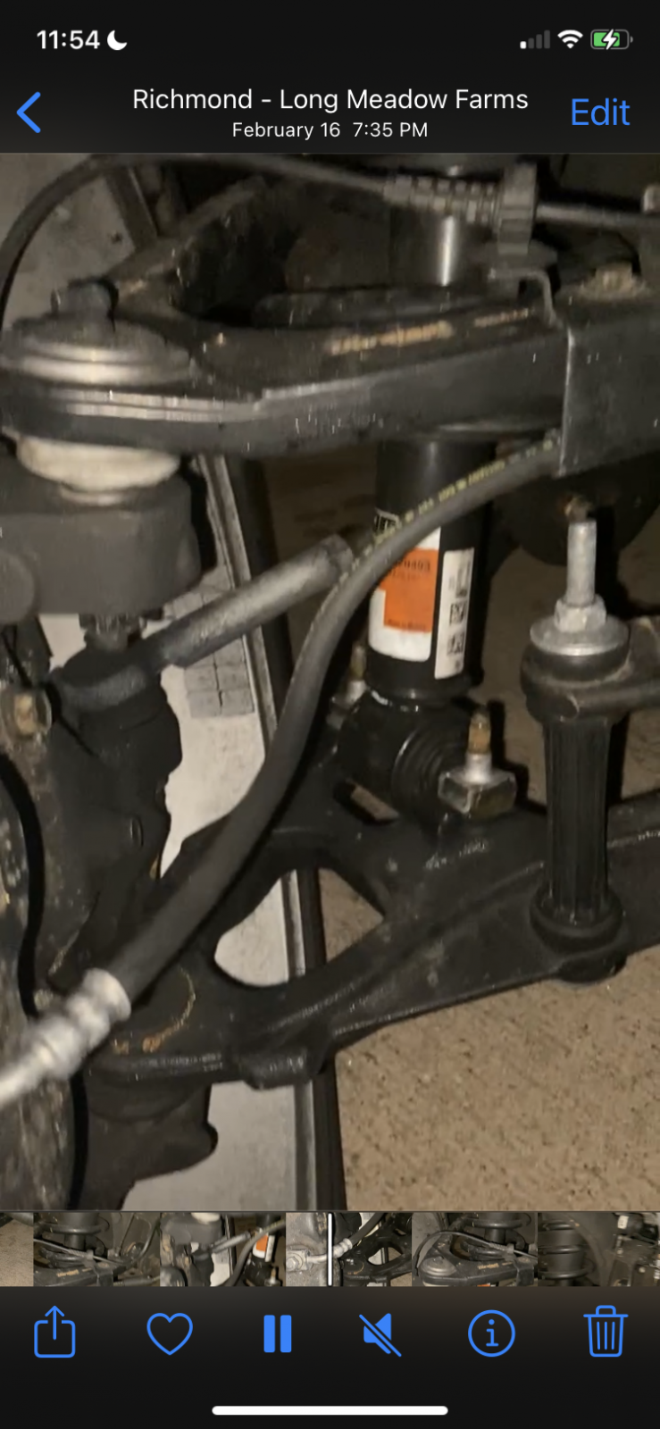

Look how beautiful the Duralast Gold upper and lower control arms look with my OEM sway-bar end-link! I also replaced the upper and lower insulator and isolator. This was my 2008 Escalade that had 207k and lived in NYC Queens from 2008-2021 1/2. We had some of the worst weather storms some years was record like Xmas 2010, 2016 & 2018. I kept my truck clean with wd-40 and pressure cleaning it every other year. My springs, hub bearing & knuckle was original as well.
