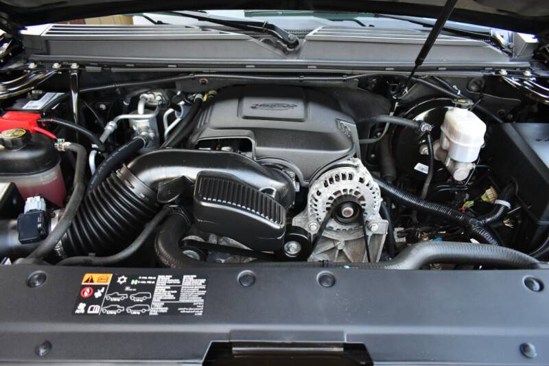

I am finding that Tahoes/Yukon/Suburbans are either beat up pretty bad from this era or in "great" shape with low miles that one has to pay for. I'm not one to pick up a truck with 100k miles to save $5k where it looks to be pretty beat up on the inside.
Even those with 60-70k miles are asking for close to $30k as these vehicles are sought after for running for as long as I'm sure this braintrust already knows. This one jumped out to me to just how darn clean it was (I know pictures are just pictures and detail guys can be incredible), but the Georgia lifer (I'm outside of Atlanta) also really drew me to it. Love the black on black, but was curious:
Is the Onyx Black paint on these known to hold up or should I target one of the tri-coat colors instead?
Thanks so much for the advice above!!

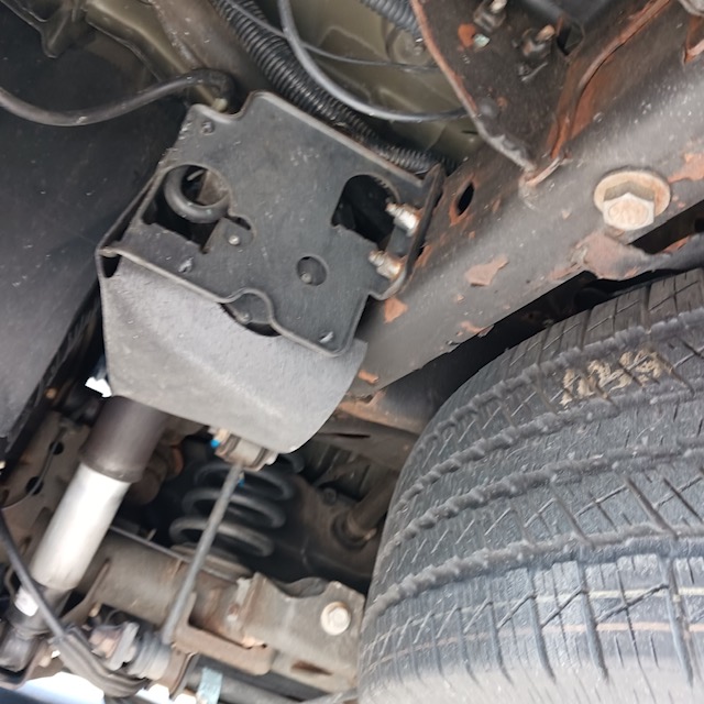

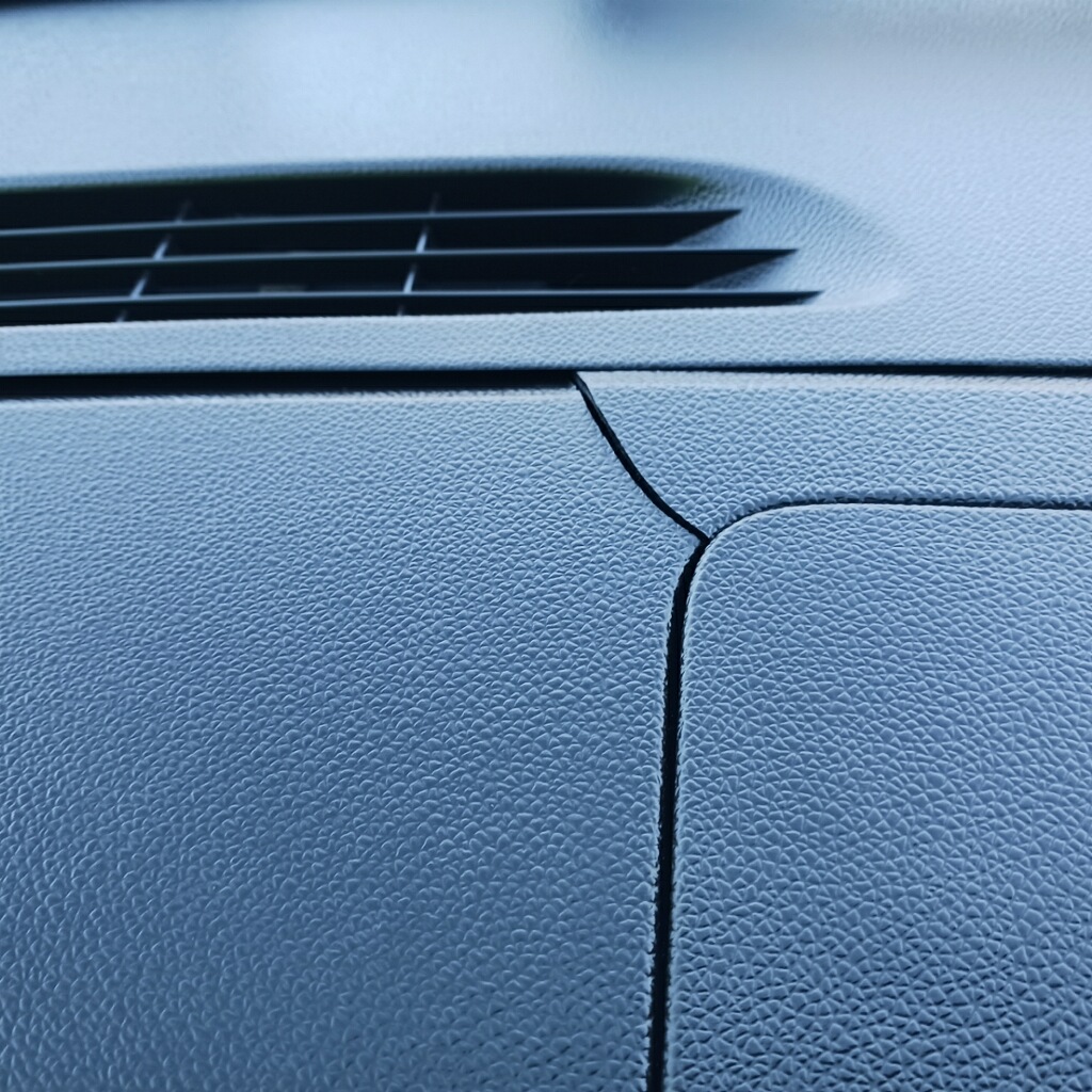

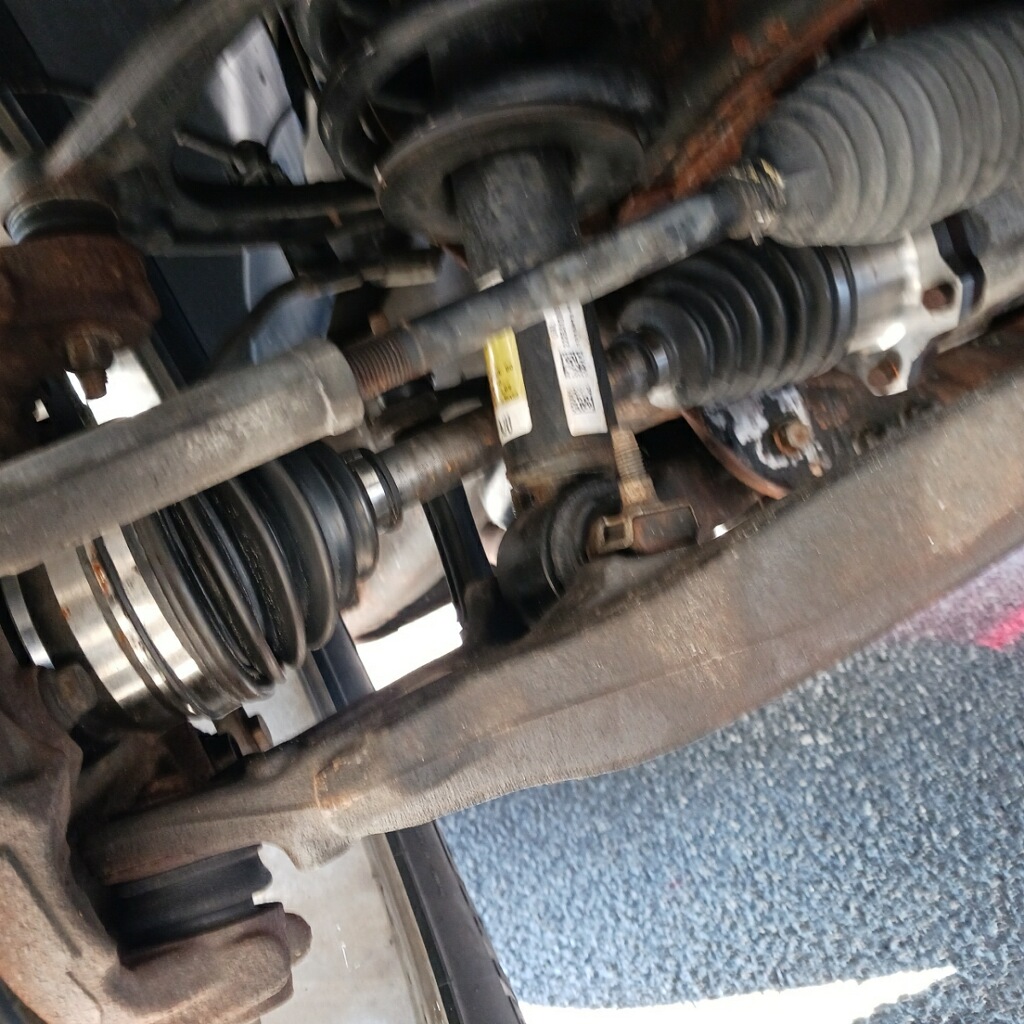

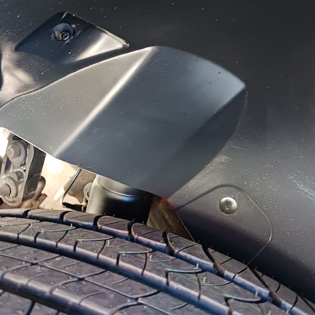

here are a few pics:

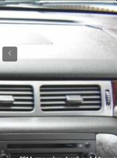

The dash is cracked by the passenger air bag.
