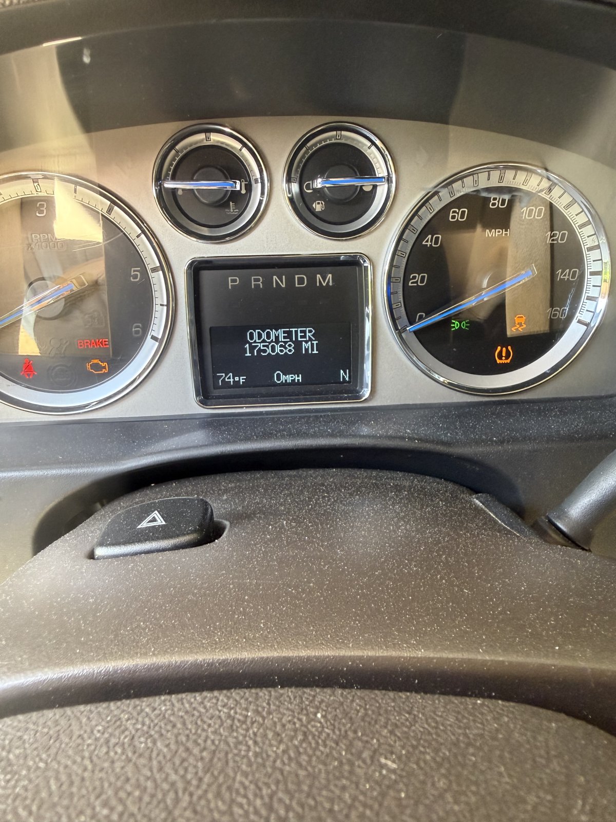

When I was done for the evening, I tried to open the lift gate. Nothing. Key fob, handle button at the liftgate, rocker switch in the headliner, nothing worked.
I also noticed the DIC in the instrument cluster was displaying a raft of messages.
Most relating to alternator and engine harness disconnected.
I did notice there was no vehicle speed indication, just three dashes.

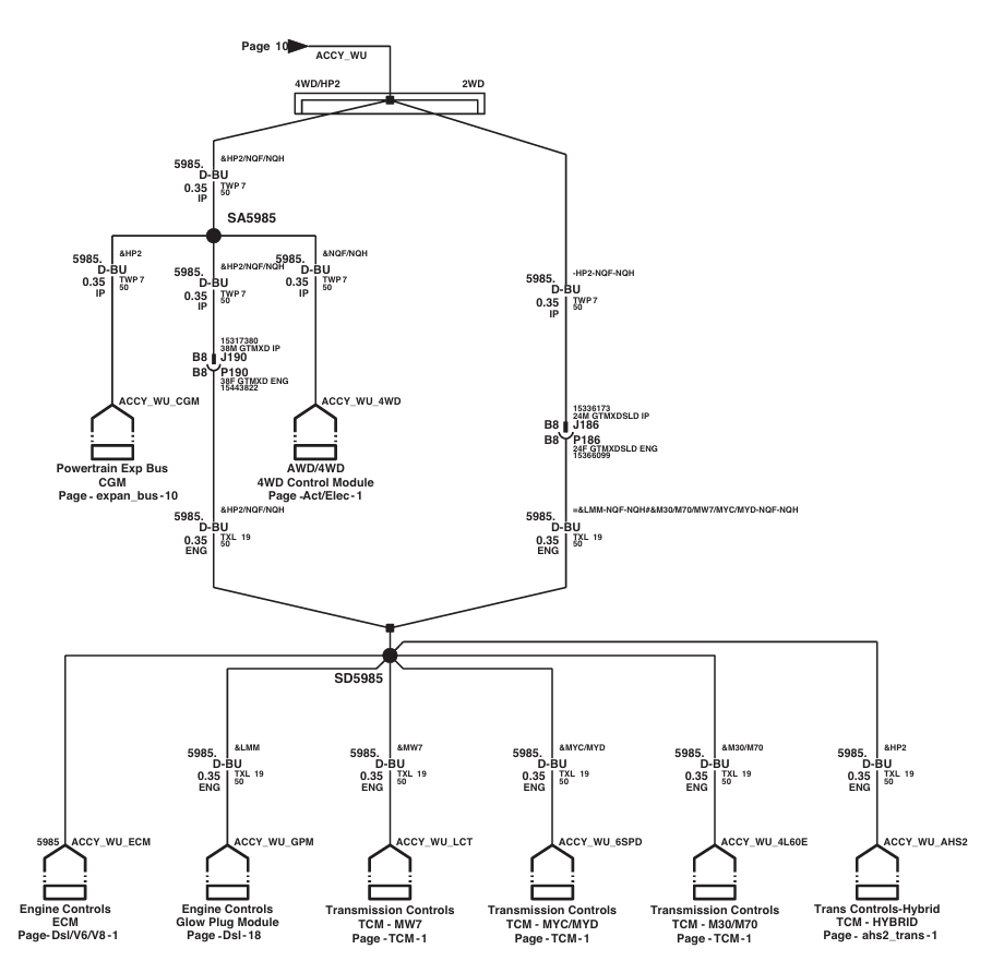

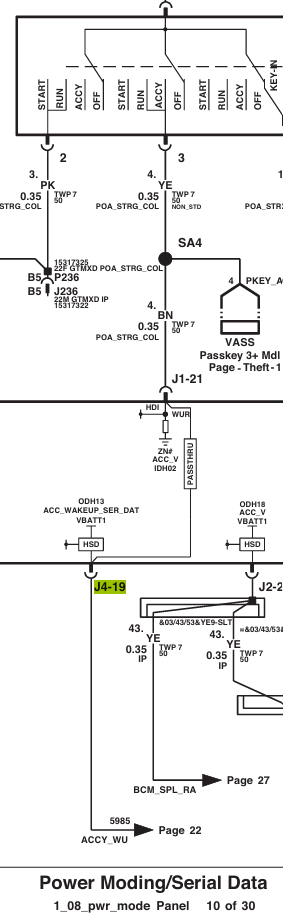

There is an accessory wakeup signal, goes from accessory position of ignition switch to BCM, which apparently wakes up other modules, but passes through BCM to power the ECM and TCM wakeup circuit.
not saying this is your problem, and I don't see how that circuit would get zapped..
So hoping a reset like geotrash recommended might solve it.
