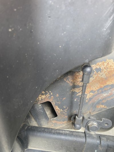

@13_Metallic I see multiple things wrong with your suspension.
1.) Ride level sensors are maxed out, that's bad. I can't tell which struts those are but lets assume they are the factory struts auto ride.
2.) Rear shocks are fully extended at ride height, also really bad.
3.) Rear sway bar end links are too short now your rear sway bar is at crappy angle.
At this point you need to decide if you want to keep auto ride. I'll give you a hint, you need to get rid of it.
I recommend you get a set of 4 bilstein 4600s or 5100s, rear shock extenders from Rough County, Moog 81069 rear springs, and some 3 inch lift JK sway bar end links. That should set you up nicely.
As far as a light coming on how do i prevent that? Since i will be removing the autoride?

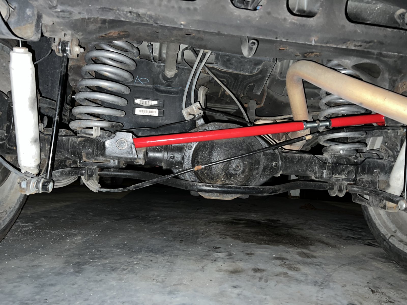

How’s it going . Been on here a few times trying to get some help with my tahoe and still really don’t know what to do. So i have a 2013 LTZ Tahoe with Z55 the tahoe has a 3inch lift from what i was told from previous owner. Under front struts and then a spacer under the rear coil spring. And man it rides like absolute crap you can feel every bump and dip in the road. Its on 22x12’s and 33’s but my sierra had the same set up and did not ride this bad. Any help would be appreciated. Really hoping to not have to get rid of the Autoride or have to get a bigger or smaller lift. But I definitely would like to figure out why its riding so badly compared to my truck. Thanks Guys!
Sounds like the lift is stretched out so your uca may be bottoming out? Are the bump stops cut out already?
I had the same issue I put bilsteins on my Silverado and they ride good
I did icon coil overs on my Tahoe and used spacers to stretch the 6” lift to a 8” and between the coil overs and the uniball upper control arms the ride and handling changed dramatically it was night and day I went from hitting rail road tracks at 45 with both hands on the wheel to jumping them at 75-80 driving with my knee cap and sipping on my coffee
I’ve always hated the auto ride shocks they suck in my opinion trash that shit and get you some good shocks on that rig! And don’t spend money on a new lift kit it’s not the lift making it ride bad it’s the shocks and stretched suspension.
I have a rc lift on the Silverado and a fabtech on the Tahoe both are about the same minus the fabtech has slightly better lower control arm angles
