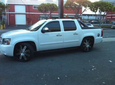

Any good rims shop could help with the correct offset, but as far as tires for 26's, 295/30/26 would be your best bet with no rubbing. A buddy of mine got a set of Sunny tires in this size for $900 installed. And his truck is lowered 3/5. Very minor rubbing on big bumps. Here is a pic of 295/30/26's on an avy with a 2/4 drop. Hope this helps:)

Talk about a new type of tire stretching lol!:shocked:
