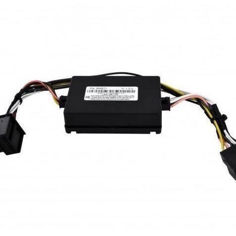

Integrated option for A2DP BT music that plugs into the factory harness in 5 min. $79
As goofy mentioned below, you’d have to look behind your glovebox when it’s upper (concealed) flip down latch reveals what’s behind the door.
I suspected that ISS did not note compatibility correctly. In the Tahoe / Yuke / Burb vehicles around 2011/12 equipped with the hard drive memory Navi systems, the XM modules are separate from the Navi units. These are the units that accept these A2DP BT devices
Apr 11, 2018
5,835
11,028
St. Louis
My 2012 has a built-in XM tuner in the head unit.
I bought something like this from Crutchfield a couple years ago and looked everywhere for the XM receiver behind my glove box but didn't have one. My XM antenna cable plugs into the back of the radio head unit.
Crutchfield was great and took it back and even refunded me shipping. At the time they had it listed as working on my model year and did not know that some radios have built-in XM and this will not work. Now they have it noted on the product page.

I ended up buying this Bluetooth adapter from post #9, and it works well. I like that it has the Apt-X format compatibility, and works well with my phone. Sounds more than acceptable to cover up the exhaust manifold leaks.
