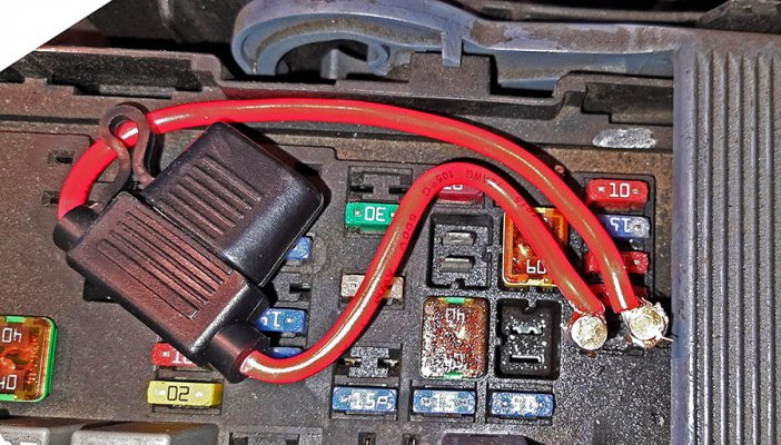

OK Here's the UGLY BUT RUNS for now. THANKS to everyone who helped with this. It's an amazing Forum of Friends...
AND Thanks for the parts pointers; I have found a VIN matching fuse panel within 50 miles. THAT will be the actual solution.
BUT In The Meantime:
The UGLY connection with soldered Bronze Nails, 25A Fuse and holder:
That carefully hammered in place, just aside the broken-off fuse legs. I sprayed some contact anti-corrosion stuff first.
The Fuel Pressure came up to 55 PSI and started immediately. After warmup pressure was 45PSI.
(Don't know how to put text to right of that....)
Warmed up, ran smoothly all the time. Locked brakes and put some throttle/torque in Drive (in the barn..) All smooth running.
So I need to carefully secure that fuseholder and get the cover back on.
The Bullseye Shot by @Fless : "SWAG: Check power on both sides of fuse #21 for the Fuel System Control Module."
Just THANKS. I'll try to pay this forward. Regards, Terry

@Fless, I ran this for 10 min or more and felt the top of those nails. Not hot at all as I felt it. I measured the voltage between the two tops and it was .018V (18 millivolts) and I assume that was mostly from the resistance of the fuse/holder.
I was able to ziptie the fuseholder a bit away from the edge and was able after some juggling to get the top cover completely in place (Always difficult).

OK, AllGood!! and here's the final WhatIDid: Got used 'good' fuse block assembly. Disconnected battery negative.
- Used "Deoxit" (https://www.amazon.com/gp/product/B00006LVEU/) on most all connections:
- On the bench: Removed, cleaned and re-inserted every small fuse and relay on the used fuse block: Coated their pins and used small handle-wipe with Deoxit to clean up the fuse/relay sockets. (Some had a little white deposit).
- Turned fuse block over and inspected all downward-facing pins large and small. Wiped every one with swab and Deoxit. None looked bad.
- Inspected the mating chassis connectors and made sure they were all physically seated correctly. Did light spray of Deoxit across all those connectors, then wiped any excess on plastic parts.
CAREFULLY positioned the fuse block in place with the arms that secure it. It's fussy to get them at the correct angle. Took couple tries to get the block to finally drop evenly in place. THEN seated the retaining arms that pulled the block down, mating with the chassis connections. Carefully rubber-hammered a little on both ends and assured the block was fully placed and plugged in.
Reconnected battery negative. Drivers seat, seat belt, key, deep breath and VROOM.. Checking.. everything Works!
Long Saga and GREAT help from this Forum...
Best Regards, Terry King ...In The Woods In Vermont
