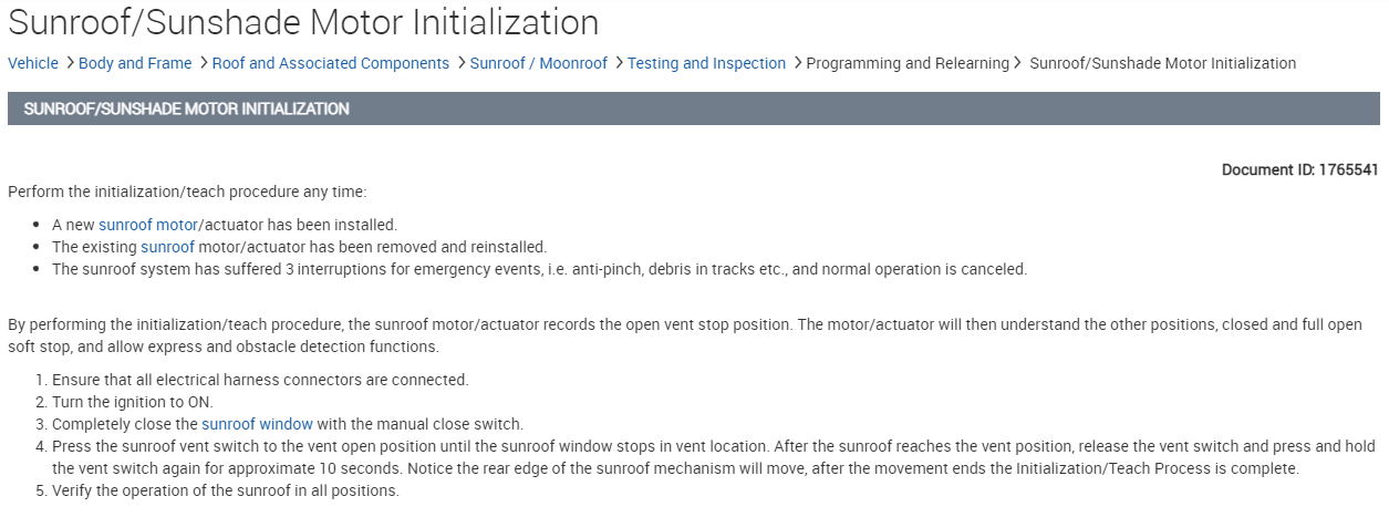

Sorry to hear this. A Tech-2 or similar can pull up the internal codes which will tell you what went wrong. The problem is usually the motor (15934722). The switch assembly is 25786403.
If you do replace any parts out on the road, follow this afterwards:
thanks for this! I unplugged it for now. Just happy I got it to close.
