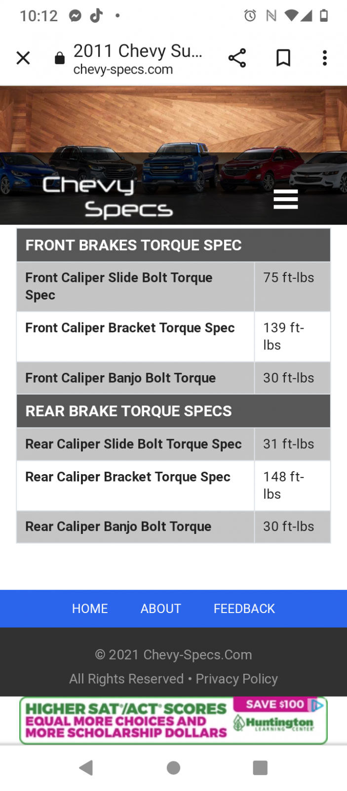

Thanks for the info.

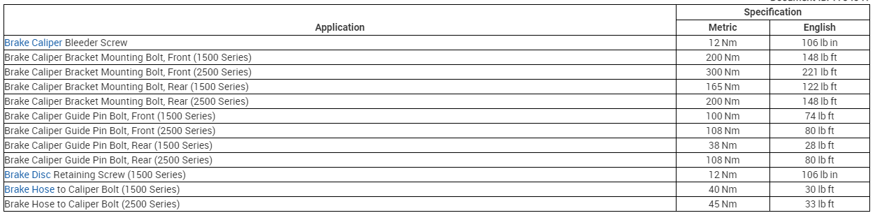

I found this info online, seems legit but differs from the numbers above.
